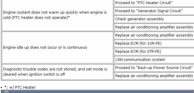

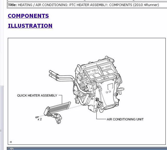

Did some research in the factory repair manual.....
It seems we do have an electric aux heater"
(PTC) available but possibly it was an option just for cold climate uses.I'm pretty sure the asteric on the trouble shooting part denotes that it's optional ,as in the *:w/PTC heater.
I know some on here have the cold climate options as they came with the block heaters .
The bad news is that AC unit is a mutha to take out to install one even if we do have the wiring harness and can get the part number for the heater.
When researching Toyota PTC heaters ,I did read on the Prius forum that somebody said their PTC heaters only work on max heat and low fan setting so maybe we do have them and somebody can further the research.
Here's from our repair manual....
