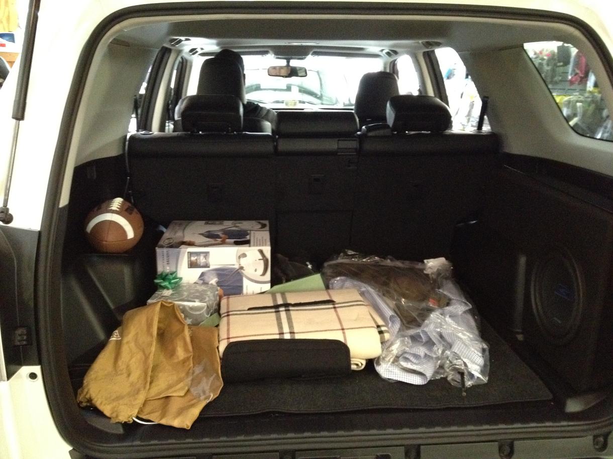

The shop I work at just got our first 2011 4Runner to get a little sound system. This one isn't particularly crazy but I figured I would share some pics with you guys. Let me know what you guys think. I already have an idea for doing the next one that we get in.
Basically we stayed with the stock head unit. This 4Runner didn't have the Premium sound system which made the install slightly simpler. We basically went with a minimalistic setup

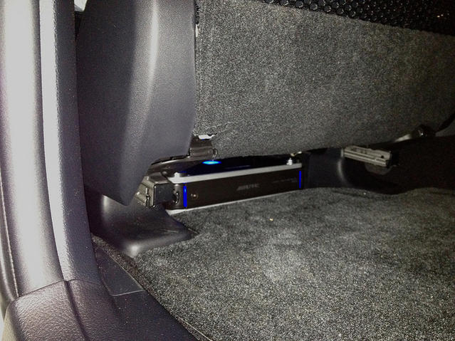

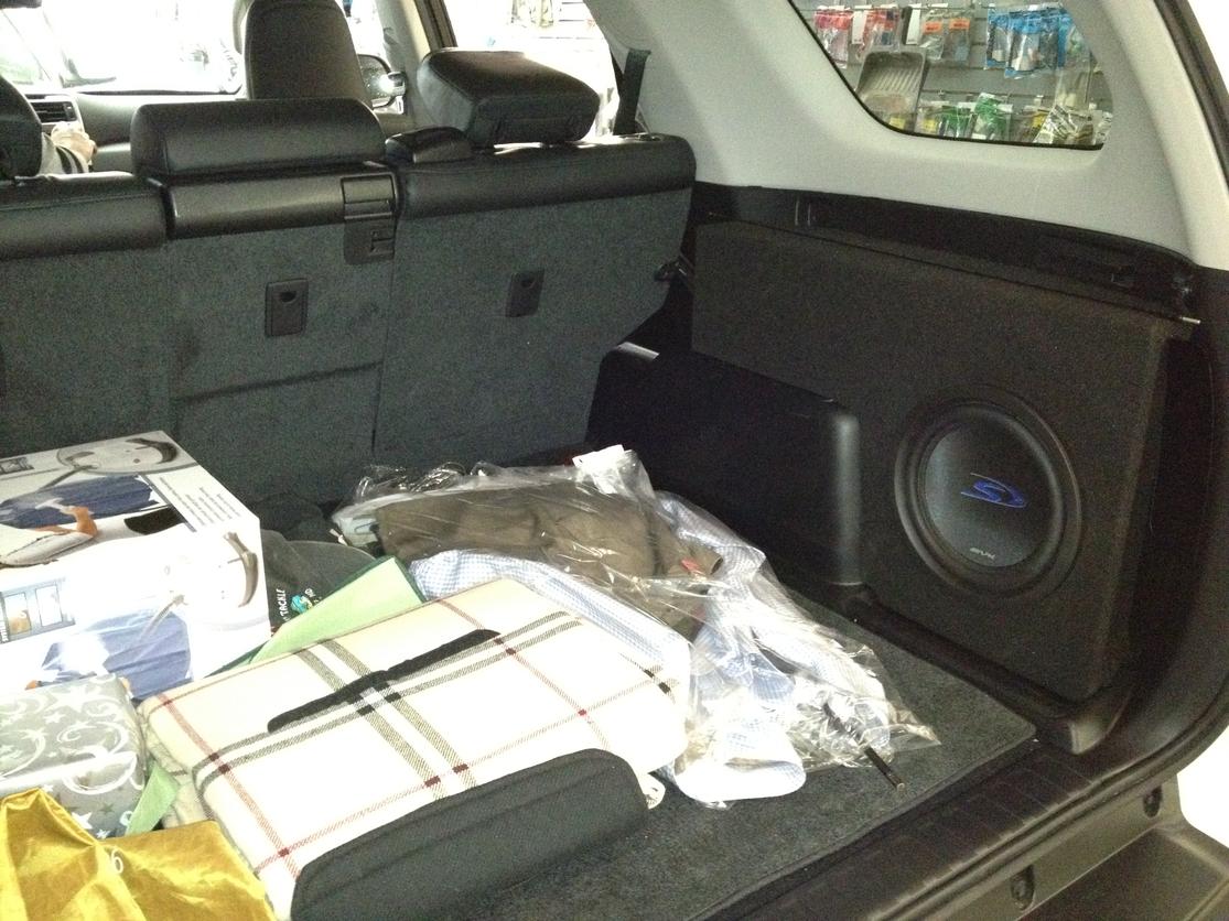

Alpine PDX 5 running the entire system. The subwoofer consisted of a single Alpine SWS-1043D 10 inch subwoofer in a custom enclosure.
1 pair of Alpine SPS-610C, SPS-610, and SPS-619. if you don't understand the model numbers basically one pair of 6.5 coaxial, component, and 6x9 coaxial speakers. It sounded pretty sweet. I must say I like the new 4Runners it makes my 2005 seem old.
The 5 Channel amp was tucked away nicely under the drivers seat and the subwoofer enclosure was installed on the passenger side rear panel above the wheel well.

That's a very clean awesome install!!!! I'm about to install my alpine 12" type R in my 2006 model. I wish the 4gen t4r's had rear wheel wells like that to build better integrated boxes around like that. Hey do u have the rough demensions of that box. Again great install man!
