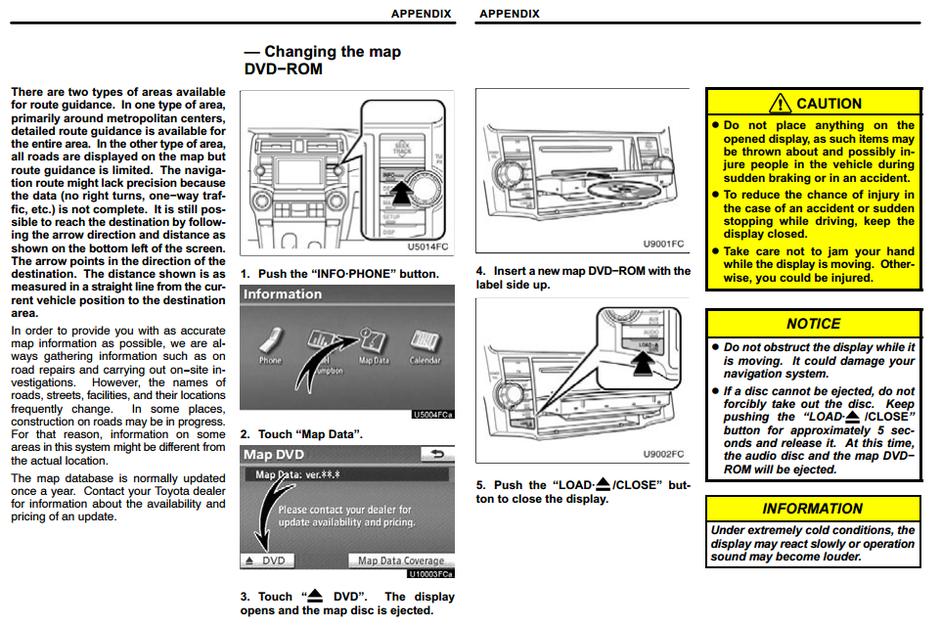

2012 4RUNNER navigation update process as follows:

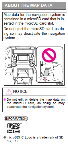

The 2016 should come with the 2015 map. The 2016 maps were just recently introduced in November. Updating the navigation on 2014-2016 4Runners is as simple as just swapping out the microSD card behind the false microSD button on the radio.

Thanks Walterego!
I am going to try one of the $29 ebay discs as my dealer wants to rip me off for $280!
Previously I had no idea that it was a disc...thought it was a dealer only download.
