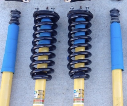

Has anyone put Tundra bilstein shocks 48510-0c040 on a 4 gen? If so what were the results ride/lift? what kind of mods did you have to do? Thanks

You will need to check the compressed lengths of those shocks to make sure you don't bend the shafts when your shocks compress.
The shocks may not be, but
Sorenson offers a kit utilizing the tundra TRD progressive coils mounded on 5100s so they must be compatible or adaptable.
Had the tundra TRD progressive coils with tundra 5100s on my 3rd gen and loved um...
So the Tundra shocks actually fit, without being to long?
3rd gen 4R and 1g tundras are compatible.
4th/5th gen 4Rs and 2g tundras are not compatible.
I meant to say the coils are
alone are compatible but i messed something up in the translation. Was in the process of side loading an android OS upgrade....:beer:
