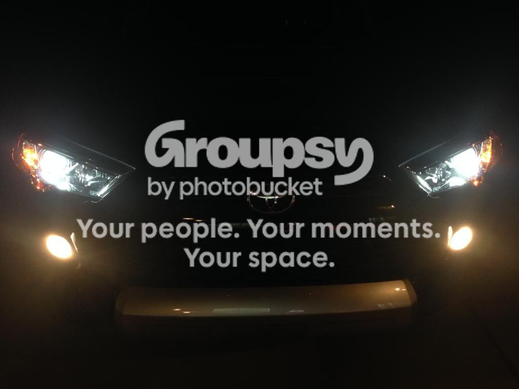

2014 4Runner Fog Light HID Conversion
To the ones that are very concerned about me blinding people I can say this. The Low beams are as bright as my wife's Audi Q5 stock HID's because the 2014 has projectors already for the Low beams
The 2014 has halogen projectors. You've put HIDs into a projector designed for halogens. The results will not be the same and the quality will depend on the make and model of the vehicle. Don't get me wrong, the results may be acceptable, but you can't tell from the pictures you've shown. You need to pull up to a flat wall and take a picture of the lights shining on the wall. That's far better than taking a picture facing your headlights.
Also, it looks like your fog lights are casting light too high. They should not be sending light that high. That's probably because you've put HIDs in there improperly. You should align them to make them more beneficial to you and less obnoxious in general.

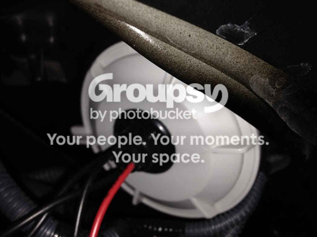

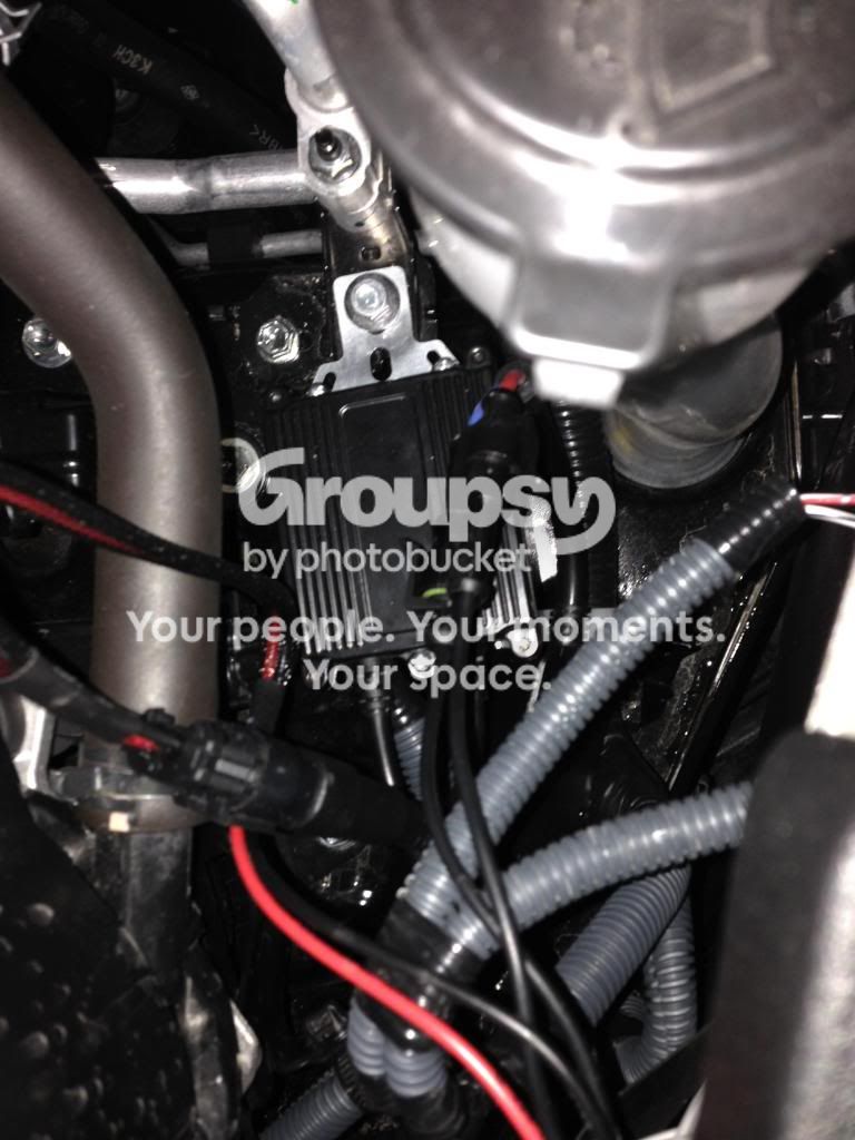

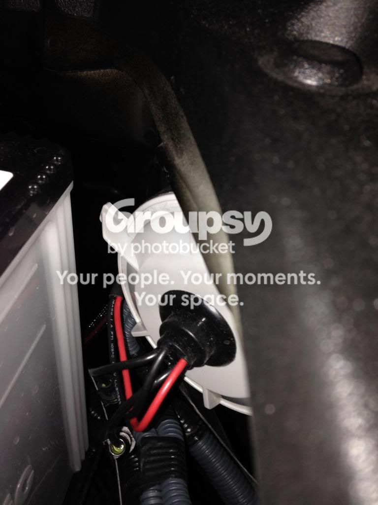

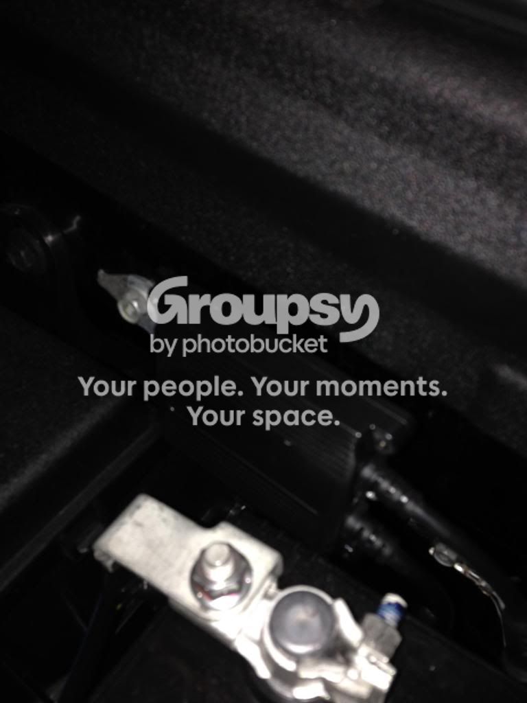

Do you have any pics of the installation on your headlights? Mostly on the dust cover that covers the back of the projector housing...
I just converted mine last week to 5000K HIDs. Was very easy. I just cut a 1 inch circle in the center of the cap. The kit I have has a rubber piece that fits around the hole in the cap. So there is still protection from dust or whatever...

Care to show any pics? Thanks for the info! I figured the 1inch cut out was necessary.

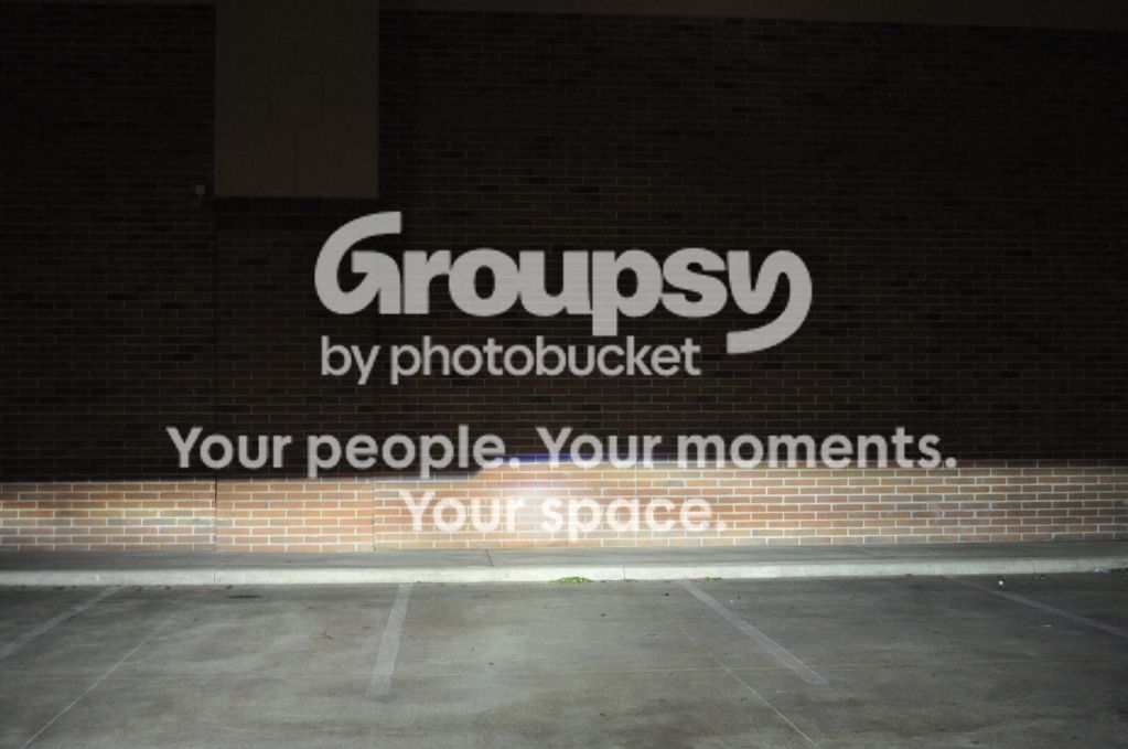

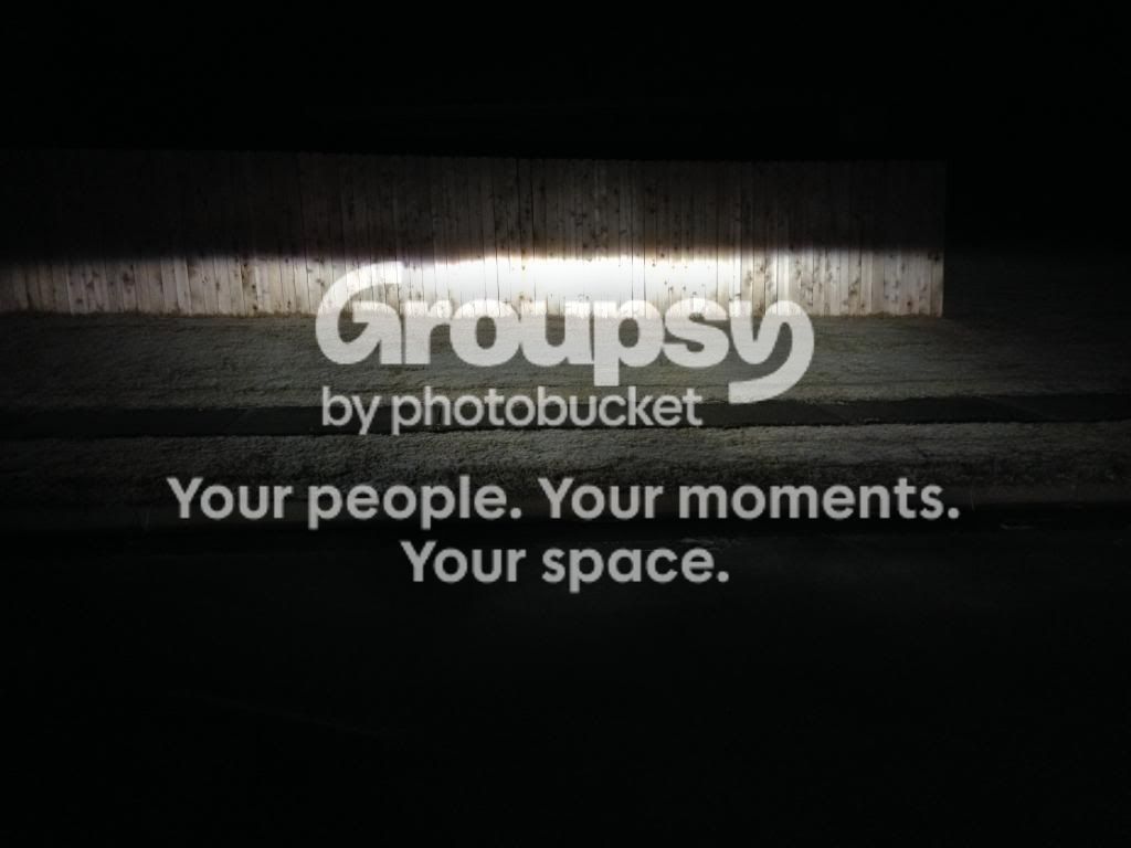

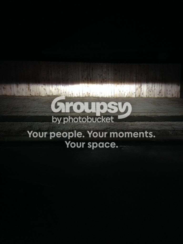

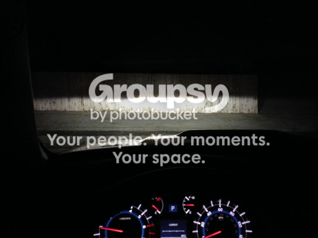

Now I don't pretend to know much about HIDs... but I think it looks pretty good. They're probably not up to most people's standards, but I don't want to spend $300-$1000 for a custom HID conversion. I also don't feel comfortable taking the headlights apart.
I know the risk of posting on a forum, so feel free to rip me apart. This is actually one of the first times I've gotten a reply to anything... People seem to like to b!tch about and hate on new forum members here.
Thanks for stepping up and posting pictures. The cutoff is better than I thought but it's far from great. It does look like it's throwing light pretty high toward the middle above the "cutoff" which is bad for oncoming drivers.
Members of the forum aren't out to hate on new members. When they see something that is unsafe for other drivers on the road they are going to express their concern. Also, the trend with a number of new members lately is to start new threads on topics that have been beat to death in the past without taking a minute to search for them. There are many members who have made this forum great with their input, knowledge, hard work, experimentation, creativity, ingenuity, etc and it's frustrating when someone comes in asking the same question that was asked three posts prior. They are asking for someone else's time when they can't be bothered to take a minute to try and help themselves.
This is before any adjustment whatsoever. I don't know if you can adjust the tilt horizontally, but that would probably help. Also... this is on a slight hill sloping to the right, just an FYI.

I don't think there's anything simple you can do. I'm not a lighting guy, but if it were simply a matter of tweaking a few things then just about everyone would be running HIDs and the retrofit projector companies would all be out of business. Since that isn't the case, I'll venture to say that if you want to run HIDs without blinding other drivers then do a proper projector retrofit. If you don't want to do that then take the HID bulbs out and get some good halogens like Osrams or Philips before you cause an accident.

The only adjustment is vertical, and unfortunately that's not the problem. Optics is the problem. Halogen bulbs and HID bulbs create light differently and the optics of their lenses is designed to properly focus the beam accordingly.
Like [MENTION=66300]Intruder[/MENTION] said, if it was simple, etc.... The only remotely inexpensive option you have is to replace the lens, which I have read works pretty well.
See here: https://www.theretrofitsource.com/
Still, that requires opening the headlight, no small matter to some. An HID bulb is just not compatible with a halogen lens.

Actually ,it's not that bad and better then I expected.Most of that light above is from reflecting out in front.The Retrofit source might have some better lens for the projector that will sharpen the cutoff.

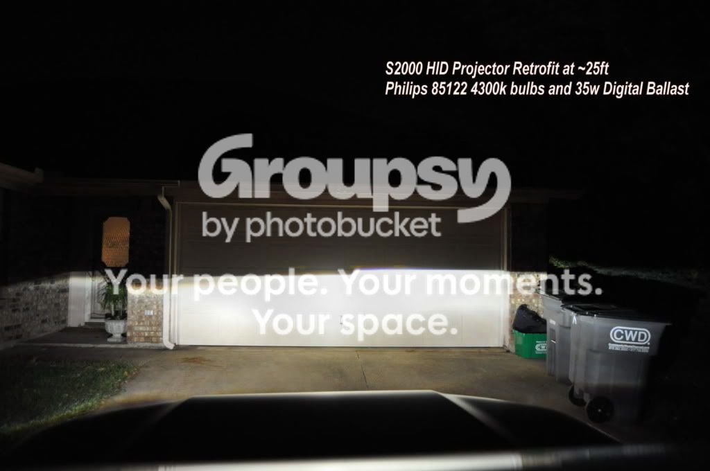

Here's a pic of my stock 10's with halogen bulbs before the retrofit and you can see plenty of light escaping above the cutoffs , what they call squirrel spotters. Some claim it's to see roadsigns but stock halogen 10-13's are some bright suckers and have more glare then 14's.
The second pic is after my retrofit and you can see the sharp and wide cutoff.My drive way is angled and reason it looks high.
Third pic is level and against a wall.

[MENTION=8206]harper7[/MENTION], out of curiosity are the above two comparison shots in front of you garage captured at the same exposure settings? If so that's pretty interesting to see that the OE lamps have almost the same intensity, just not nearly as much spread.
Might be tough to truly tell brightness at only 25ft in the hotspot since they both get washed out fairly easily.
I think D2S bulbs are rated at about 3200 lumens and H11 at only 1300 lumens. This is a huge difference (and is partially due to the wider distribution pattern as you mentioned). So any small amounts of output above the stock halogen cut off will have a different effect than small amounts of HID output above the HID-in-halogen housing.
Thank you for posting pics of your installation! So glad someone finally listened. I'm def. gonna run hids on my 14 now. Is that a 1" cutout on the dust cover?
I just did 55 Watt 5000K HID conversion on my 2014 Trail. The stock projectors work great with HID conversions. It is a 1" hole for the grommet, everything else is plug in, no wiring needed.
