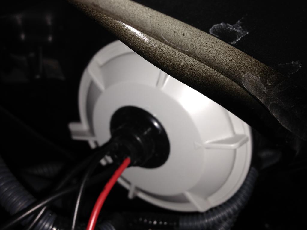

Atticus there is no need to cut a hole thru the housing cover. There's an existing hole on the bottom of the projector housing where the stock wiring passes thru, the black plug on the HID you see above you will just plug up the old hole.

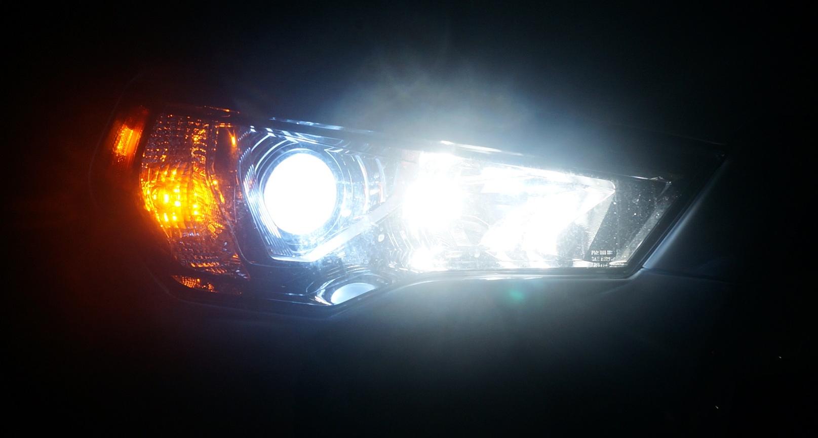

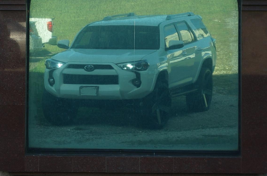

HID Selfie
10K 55W LOW
8K 35W FOG
Dual voltage 20w/40wLED DTRL
HIGH BEAM

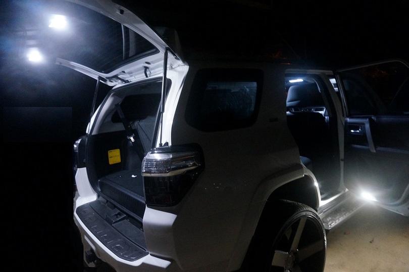

FULL LED INTERIOR

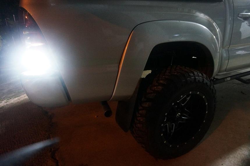

Final Phase is to throw in HID reverse similar to my TACO these are 35W

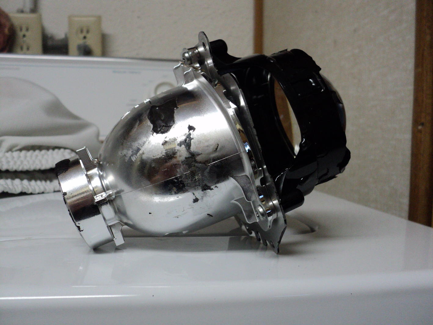

I've worked with many 4th gen (06-09) 4runners and they had the halogen projectors also. If the 14 projectors are similar to the 4th gen projectors, they are decent with a drop in kit, but not the best with a drop-in HID kit. Basically the "drop off" on the cutoff becomes non-existent. But it's still not as bad in regards to glare as a regular reflector headlight with drop in HIDs.
The 4runner (4th gen at least) has really good projectors for being halogens, IMO.

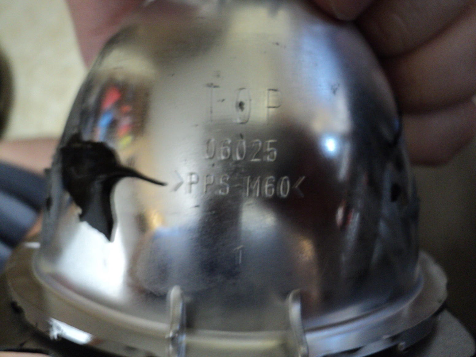

I'm curious when someone opens a headlight what the part number on the projector is. I'm willing to bet that the halogen projectors in the 14 4runners are an updated version of the 4th gen halogen projector or the same projector used in the Camry.

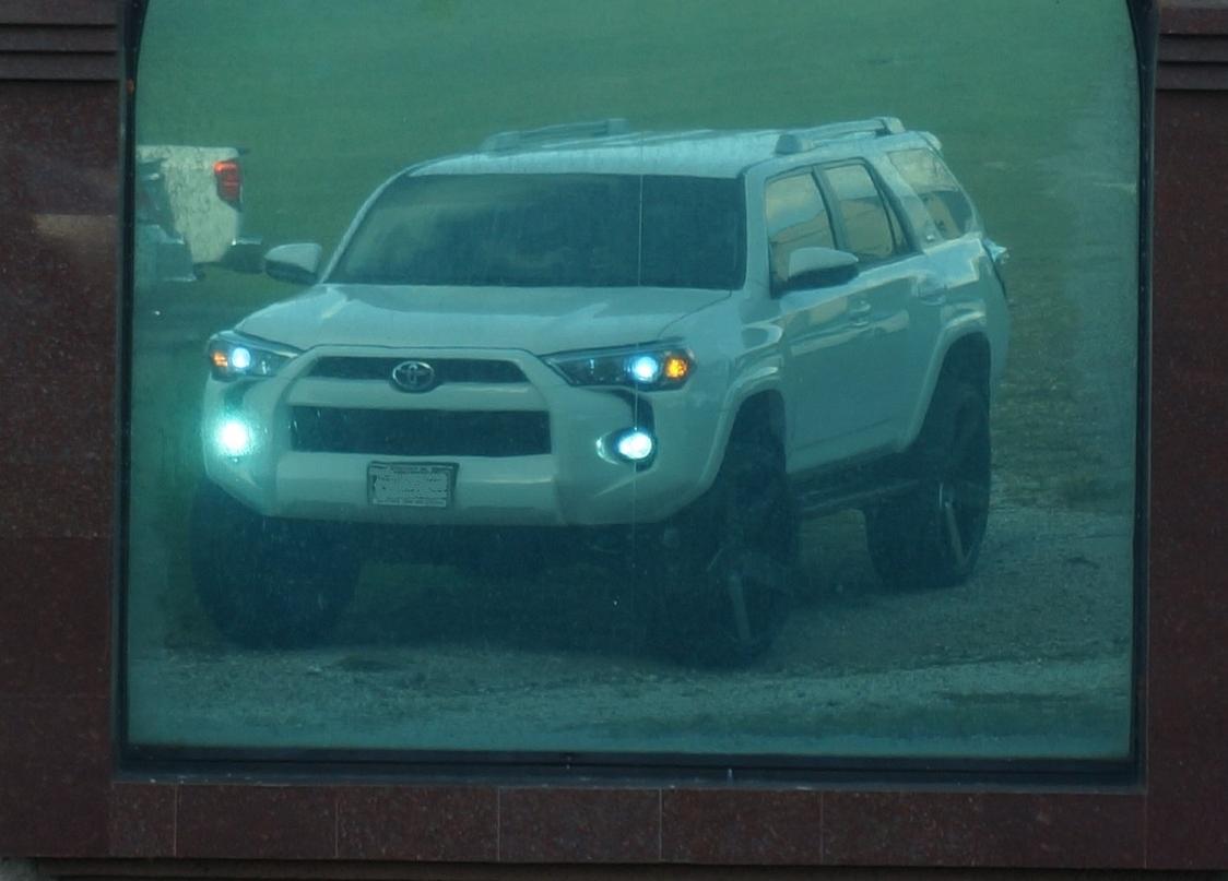

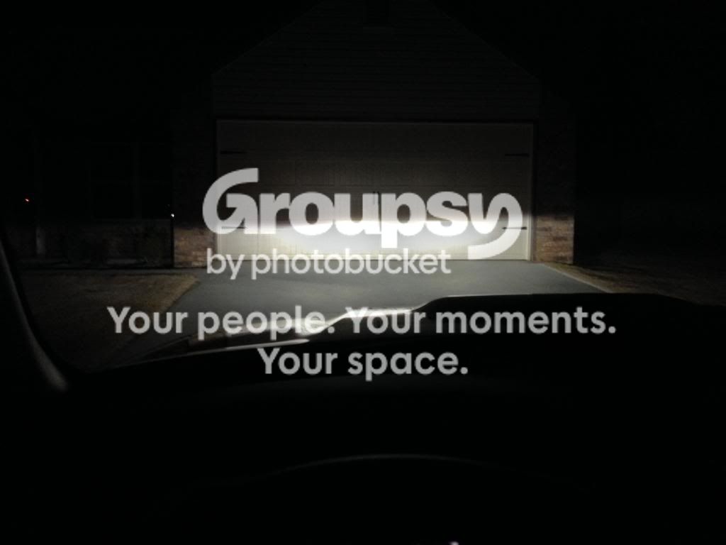

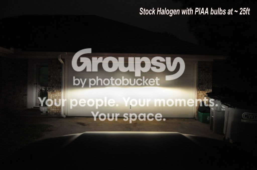

Gotta love keyboard warriors. I don't understand how someone can honestly say that the glare from HIDs in halogen projectors like this is unsafe or dangerous:
photo-15.jpg~original
When stock halogen headlights with halogen bulbs glare more than my old math teacher. If anything needs to be made illegal, it should be ALL reflector housing headlights.
Picture053.jpg~original

nothing like using 2 different pictures of different vehicles and different background (and likely different camera and settings as well) to try and prove a point..... :thumb:
Good catch. You think it's a deliberate attempt to deceive? The garage doors are so similar but yet different so I'm a little suspicious myself.
I doubt it's a deliberate attempt at deception...more like ignorance is bliss, lol.
What you guys don't see is the two beam pattern's output relative to each other. The problem with just taking an individual picture in auto mode on a camera is, it will adjust the exposure so pretty much all headlights look the same if captured individually. I can take a picture of my DRL beam pattern output against a garage and make it appear blindingly bright, but obviously that's not the case.
Another thing to consider is, the output glare from a halogen 55w bulb is absolutely nothing compared to what a 35w HID bulb puts out, so we're really comparing apples to oranges here. If you don't believe me, go look directly in a 55w low beam headlight; I would be surprised if you are momentarily blinded from that output. This is why DOT/ECE or whom ever has deemed it "safe enough" to allow some glare to escape from a reflector based halogen headlight, since it's not all that blinding to begin with.
