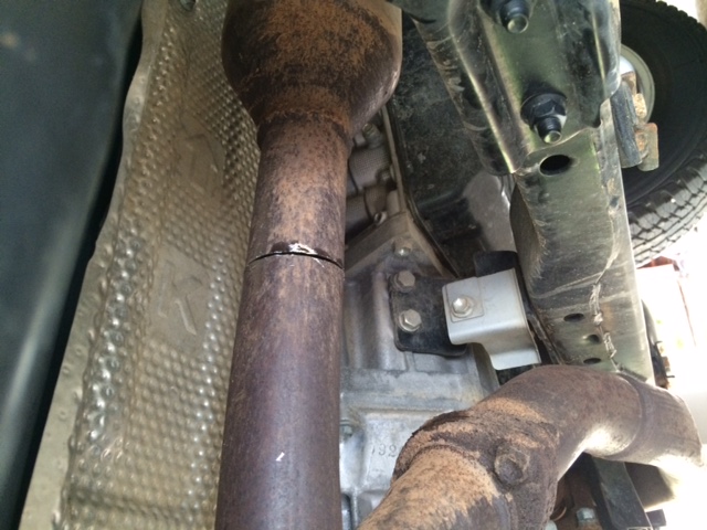

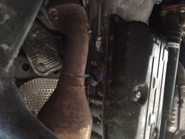

Beware: I had an attempted theft of my cat-converter over the weekend. I live in a very quiet nbrhd but my truck was in the driveway as I have a project going in the garage. After some searching, this seems to be a hot topic again with our trucks targeted specifically due to the value of the cat and the ease of removal. Keep your trucks in a safe spot! Anyone else have this happen? The fix is easy (remove and replace the part) but what a PITA.

This was a big issue several years ago but I haven't heard many cases of it happening lately. I wouldn't pay to replace it. Take it to a muffler shop and they can weld up the cut for a fraction of the cost.

The fix is easy but expensive. I would have a muffler shop weld the spots where they started to cut. A skid plate would be a good step to prevent this.

You do not need to replace them at all. Just put a fresh bead of weld and you are good to go. There is really no need to replace these.
Save yourself the $500 deductible and take it to a muffler shop and pay them $50 to weld the cut.

Hope a muffler shop can get you fixed up cheap, without the expense of replacing the cat.

Looks like they were trying to steal the post cats. Not the actual cats.
The post cats are not necessary.. and do basically nothing (besides start up ). There is no 02 behind the post cats.

Thus guy must have been really desperate because junk prices and converter prices have been down for a while now. Most people don't know this but the front cats aren't even worth that much. It's the second cat that's worth all of the money. European vehicles usually have gold and platinum inside their cats making them worth the most and most desirable. A few years ago I junked a mid 90s BMW and I got a little over $300 for the cats. That's each cat. On that BMW there is two smaller cats running in parallel. They supposedly have a high content of gold/platinum inside them as most European vehicles seem to have. Btw sorry to see your truck got harmed. It looks like you can throw some weld on the cuts and be ok.
