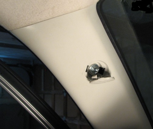

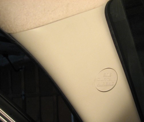

I mounted a scangauge with a blendmount on the rearview mirror of my 2014 SR5.

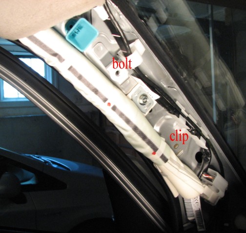

This required removing the driver-side A-pillar trim to run the cat5 cable. I looked at the 2010 service manual, but I think the 2014 is different, so thought I would document what I did. My 2014 A-pillar trim was attached with 1 10mm bolt, 1 claw, and 1 clip.
1. Pry open the bolt cover with a small flat-blade screwdriver. The cover is labeled "SRS curtain airbag". Remove the 10mm bolt. See first 2 pictures below.
2. Pull gently from the top, detaching the clip above the bolt, then the claw below the bolt. See third picture.
That's it. It is not tethered and comes completely out.

Thanks for the pictures - there's an old thread about whether supports exist behind the driver side a-pillar trim for a possible grab handle retrofit. It's hard to tell from your pictures, but I can see a few holes where 10mm bolts could go. Was there a threaded hole below the "clip" label in your picture that you noticed?
Hi gringo,
I didn't see a second threaded bolt hole on the driver-side A-pillar near the clip.
The bolt behind the driver-side airbag cover is 3.75" below the top of the trim piece. The top of the passenger grab handle is the same 3.75" and the bottom of the passenger grab handle is 7" below the top bolt. On the driver-side pillar, the clip is 7" down from the bolt.
Bill
I imagine they are not too securely mounted (i.e. just mounted to the trim pane probably) as the A-pillar trim is designed to rupture in a controlled manner for the side curtain air bags.
