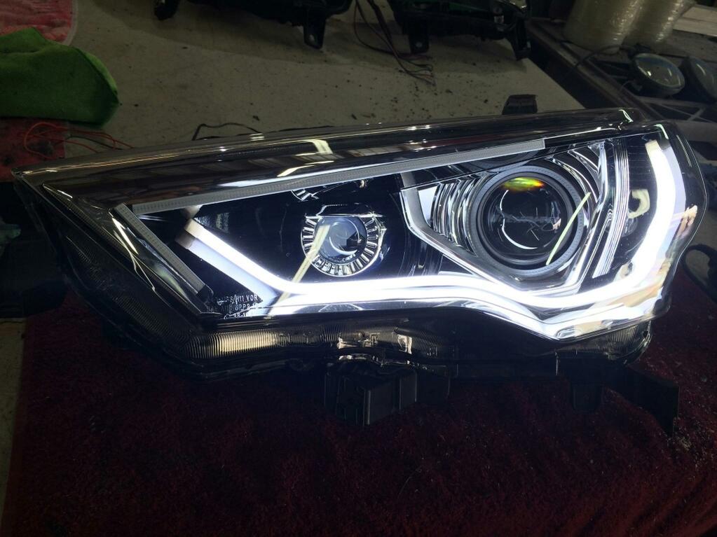

should have put a daytime led strip where you painted the chrome arrow inside the headlight assembly.
just my cents :)
otherwise nice looking.

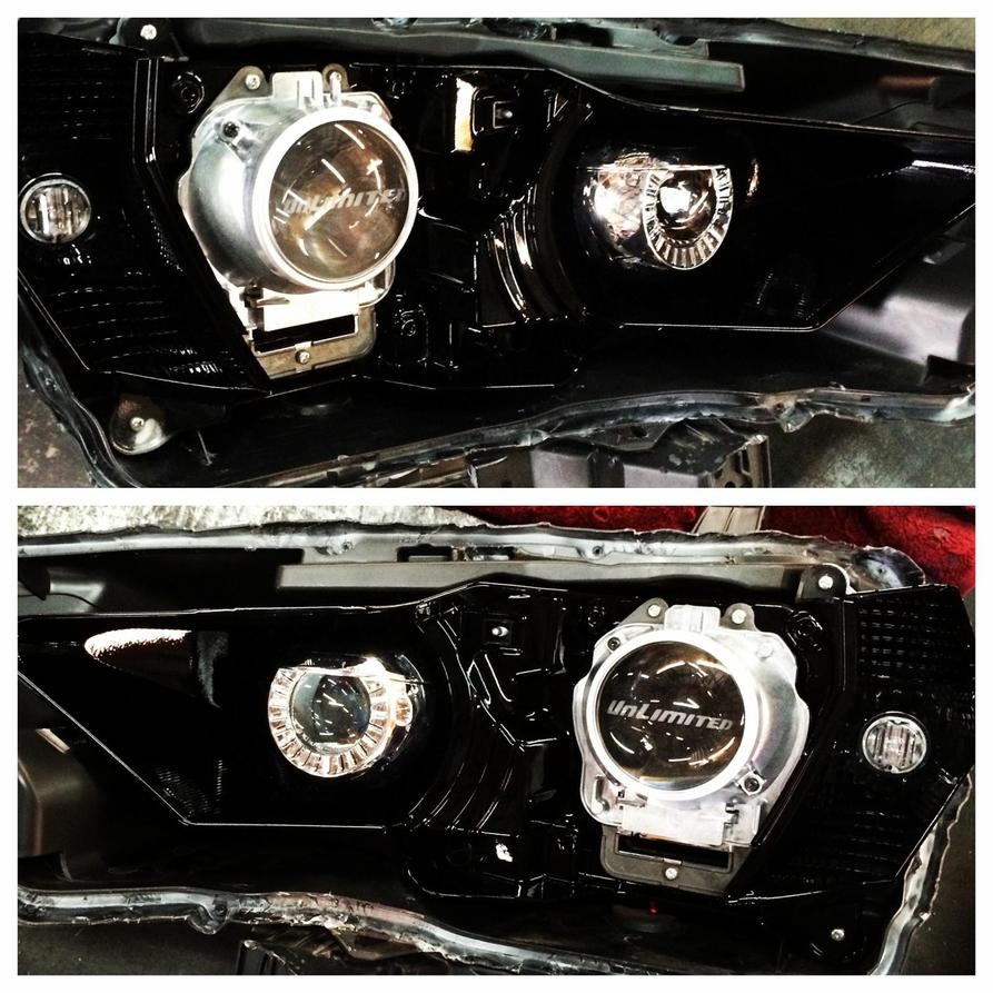

That's the route I took when I did my retrofit on my '14 Unlimited last Spring. The Retrofit Source supplied all the hardware. Something they did that I thought was cool...the etched "UnLimited" on the main projector and added a second mini projector where the stock DRL was.

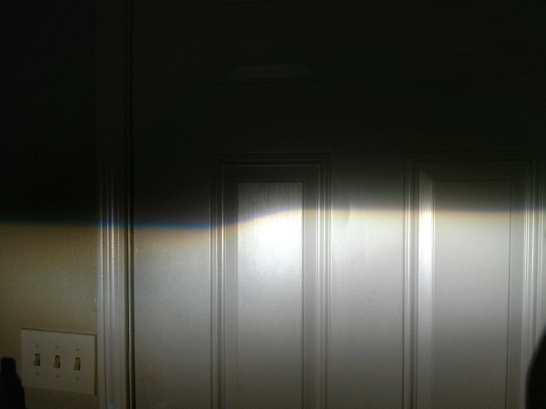

The cutoffs are really clean and have tons of color

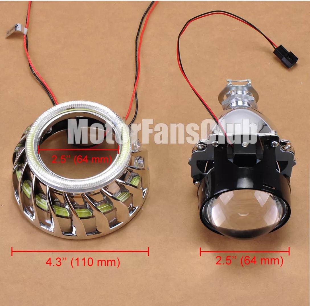

I am considering retrofitting my stock headlights with halo shrouds. The shrouds I'm interested in are 2.5"/64mm, but I can't tell if they would fit? Any idea how complicated it would be to install these?
