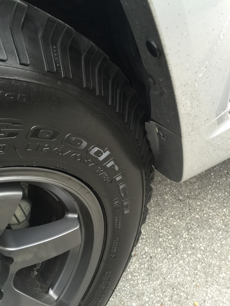

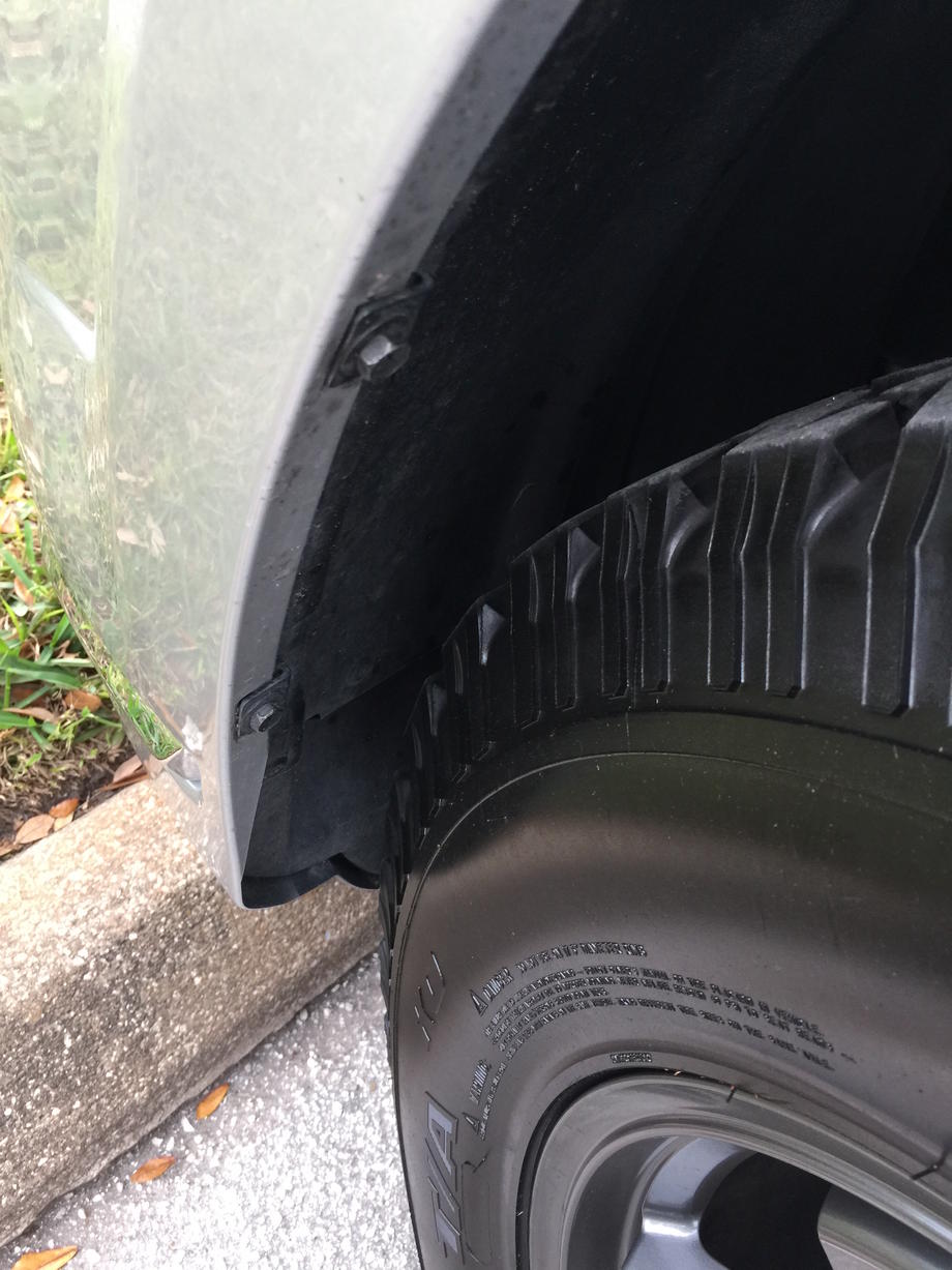

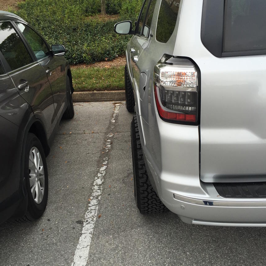

I wanted to add this thread to get others 0.02. I installed 1.25" spidertrax spacers yesterday on my 2014 limited with Toltec Boss lift. I have 275/70/17's on MK6 17x9 Wheels. I have rubbing in the front and back will see if it is easily able to be fixed.

I assume the wheels were bought with the correct offset already, why the addition of spacers? Do you have pics before the spacers? And did you have any rubbing before the spacers?
Spacers will do that, especially if you're already running wheels that are pushed further out than stock and you're running larger than stock tires. Either start cutting and trimming fender liners (possibly a bmc) then get your caster changed, or take the spacers off.
I would recommend taking the spacers off and see if it rubs, looks like taking them off would make the wheels/tires flush with the body for a better look. I may be partial though, cuz if you take off the spacers, I'd be interested in buying them! haha. PM me if you decide to sell them.
