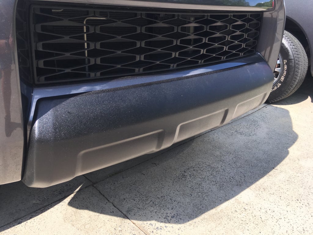

Just bought the rustoleum rattle can bed liner. after giving it a quick test on the ground in front of the spray paint rack :bounce: and letting it dry i discovered it has a very rough a durable feeling to it, not quite textured per say but just rough and I really liked it. I've removed the front valence this afternoon and will give it a shot tomorrow.

Food for thought on using this. I have an off-road trailer I used this to line the inside of. The rough texture retains the dirt. It tougher to get clean than you may anticipate. It is durable and does the job though. Ensure you prep the surface well.

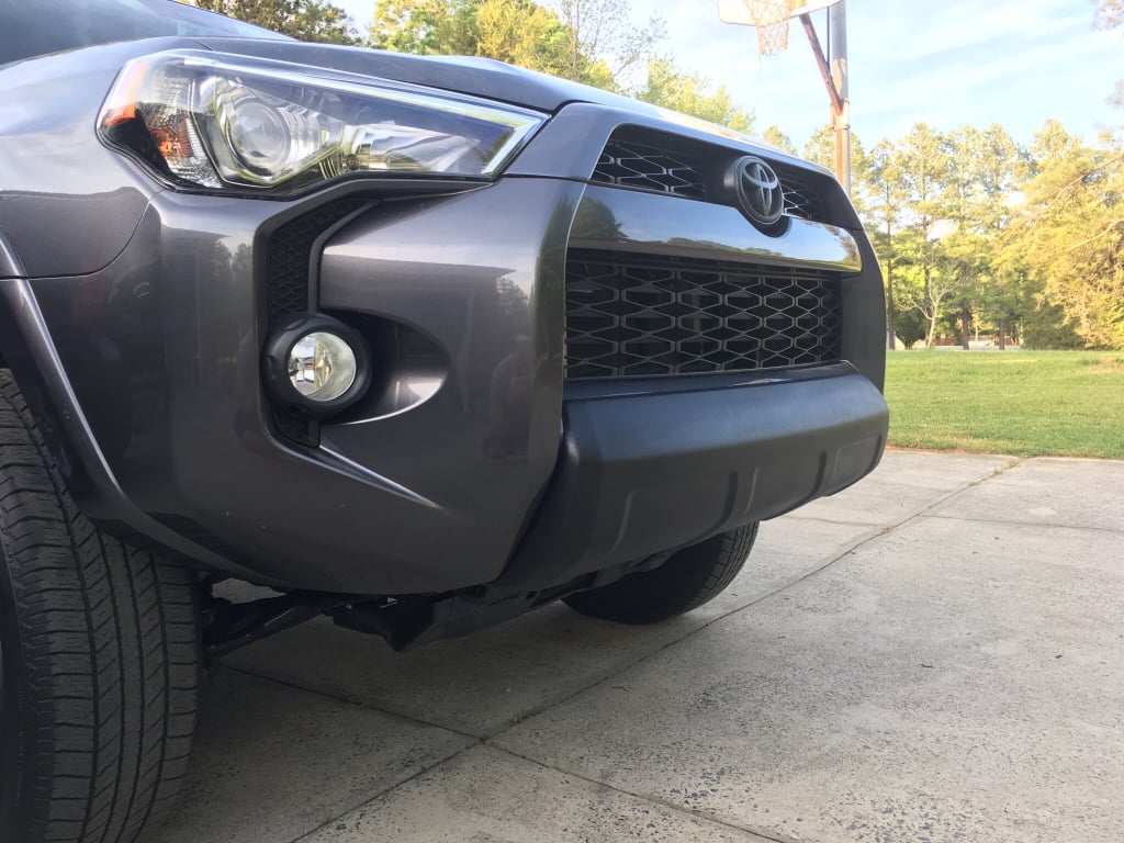

Finished the front and reinstalled it yesterday and I'm really happy with it!
I can see what you're saying about it holding dirt though.
Came out great. My fenders on my jeep TJ have the same coating. A quick hose off gets rid of most any dirt no big deal. I mean these are off road vehicles anyways not showroom cars.

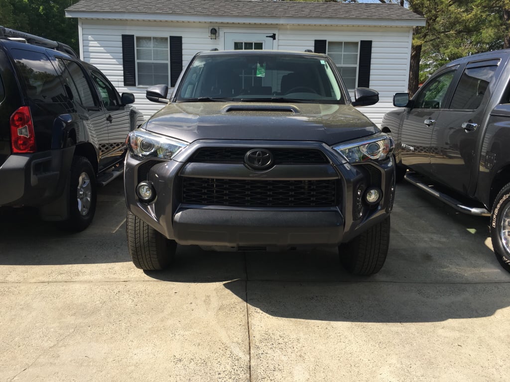

Thanks to those of you who posted about removing the rear bumper. I was donated a rear Pro valance and will install it when I get some free time.
If you replace your front or back bumper, most likely front, now one of your bumpers is gray and the other is some other xyz color. Looks ridiculous. Just tape it off and plasti dip. I would never waste my time removing the whole bumper when a spray can for 6$ can make it black or whatever color to match. It can also be removed and resprayed in a few years or whatever. And if you want it stock again, well there it is. Hidden from UV lights and ready to roll.
I removed mine about a week or two after purchase. It was super easy.

I had sprayed my originals with some Rustoleum and it looked great, the problem was after a few months the front valence gets hit with all sorts of road rockets and starts to show silver freckles, coming from the Jeep world where I have plastidipped many things, it can start to peel over time, I decided to just order a new set of valences from the dealer and have them coated with Line-X.
Cost was $200 total to cover both.
This will last far longer than rattle can and plastidip...
plus I like the way it stands out more.

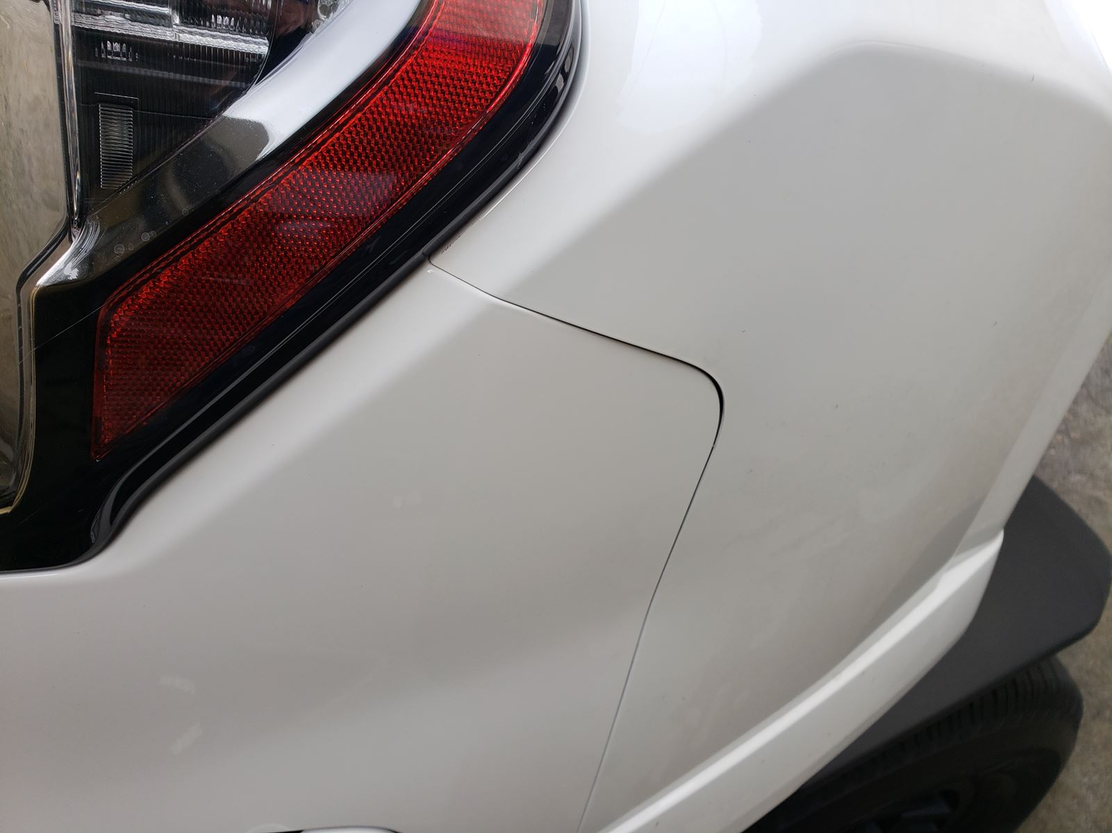

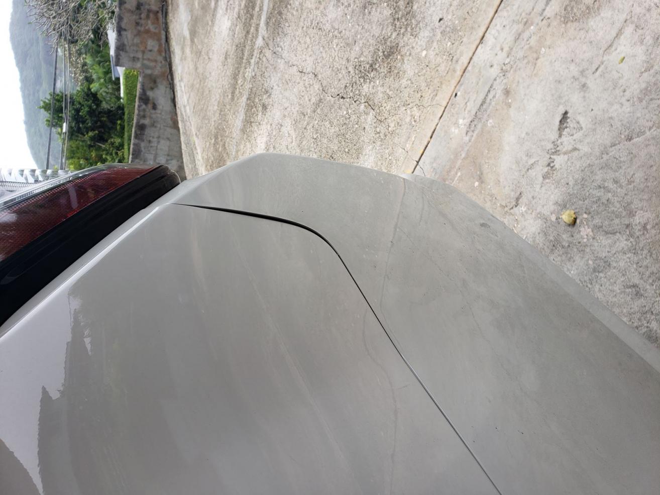

rear bumper reinstall- corner by taillights??
looking for a little direction on how much gap the bumper corners just below the taillights should be. Not sure is it's just me or if it should be that much space. Both sides look identical after removal and reinstall while putting on the TRD lower valence.
Does this look right? Is there a secret to get those 2 very small white colored clips on the bumper to grab the frame better? I tried several times from different angle, similar results.
Appreciate any guidance. Thank you

Did you figure out the spacing? I'm about to start the same work
yup, came across another post on 4runner.com.
The issue was the clips being bent downwards, you gotta really look at them to notice. Take you time, be sure the clips are pointed so it goes over the edge and it will grab like it did from the factory.
