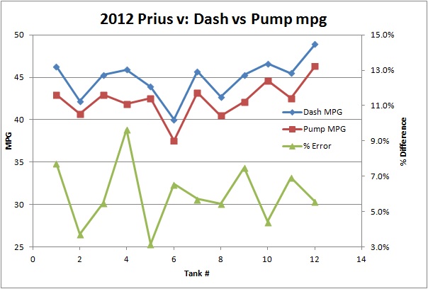

The ECU calculates MASS of fuel injected. It then uses a density conversion to calculate VOLUME of fuel used for your dash display. Density will vary with temperature and brand, among other things. The actual volume of fuel used it how much you put into the tank via the gas pump.
Long term, using the pump volume and odometer mileage is the standard for vehicle fuel economy. Within a tank, I'd say the dash output is an excellent estimate for fuel used when comparing different routes or speeds. Comparing tanks back-to-back, both the dash and pump have errors. The dash can't compensate for the fuel density change and the pump won't always refill to the same level.
For the last 12 tanks on my Prius v (waifu drives the 4Runner), the dash mpg has averaged 6% higher than the pump mpg. Min of 3.2% higher, max of 9.5% higher.

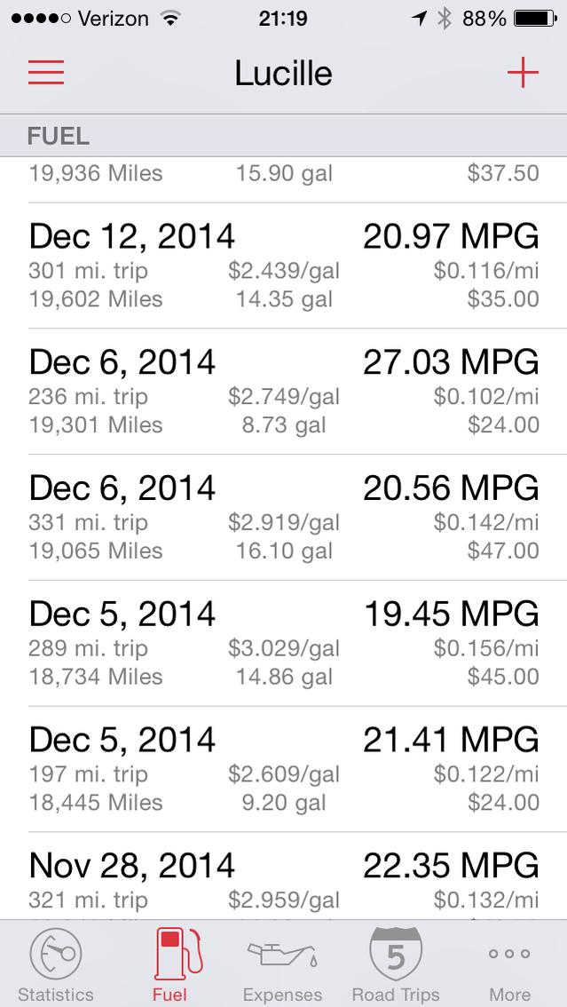

Best I have achieved is 27.02, filling up in Del Norte, CO and returning to Denver, up CO-114 to US-285, keeping the RPM's up in the 4000 range for the passes, and doing 65'ish (might have done +5 over...lol)

I call total BS.

Yeah, the only way any 4Runner would get 27.x MPG is free falling from a plane.
Not sure what you had going on there, but I can guaran-phucking-tee you that your 4Runner was not and never will get anything over 24 MPG on the best of best days, hooked to a semi's bumper. ;-)

I call total BS.
Me too.
Best I got was 23.8mpg. And that was trying my best to conserve gas.
Anomaly. It is totally possible to have a tail wind for 230 miles that would give you a substantial increase in mileage, just sayin :)
Also, Del Norte, CO is elevation 7884ft and Denver is at 5280ft....
I still think that 27MPG is unbelievable...but the elevation change would definitely cause an increase of a few MPG on a one way measurement.
