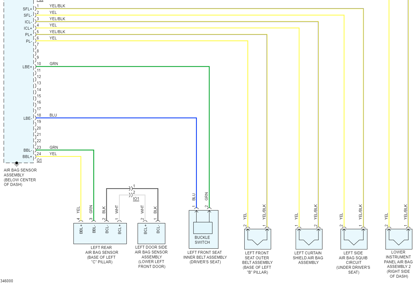

The seat belt nagging sensor is on the buckle side, by the center console. The wire connector on the B pillar is for the SRS pre-tensioner system, which is a small explosive that tightens up the seat belt during air bag deployment. They are expensive and can't be shipped by air.
In the wiring diagram, the nag sensor is the "buckle switch" with blu/grn wires, the pre-tensioner is the "base of left B pillar" yel/yel/blk wires, same as the other yel/yel/blk airbag trigger wires.
As to OP's question, I have replaced a couple and I have honestly never even bothered to disconnect the battery, though you probably should.
