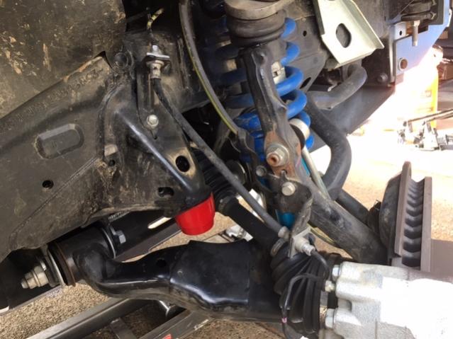

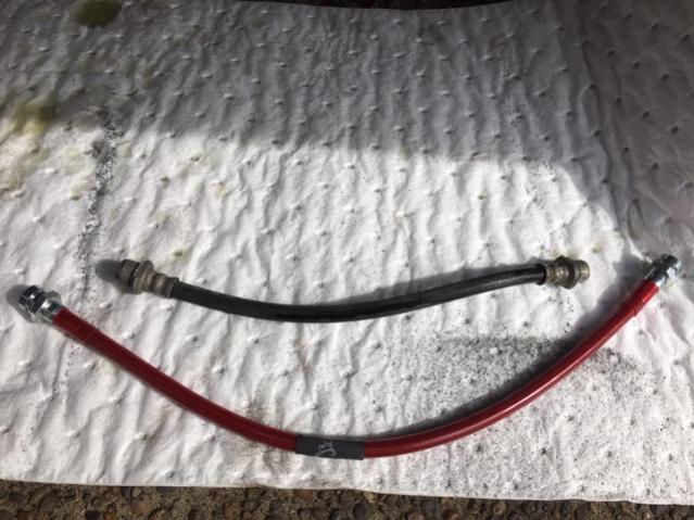

No question the brakes suck on the 4runner. Some people just don't know what good brakes are like I guess. And it is too easy to creep at intersections too if your muscles in your leg relax slightly lol Never have that issue driving any of the other vehicles. I did replace my brake lines with extened braided lines just because o fmy lift and it did seem to improve slightly.
You can see in the pic below at full droop and turned the brake lines were stretching
