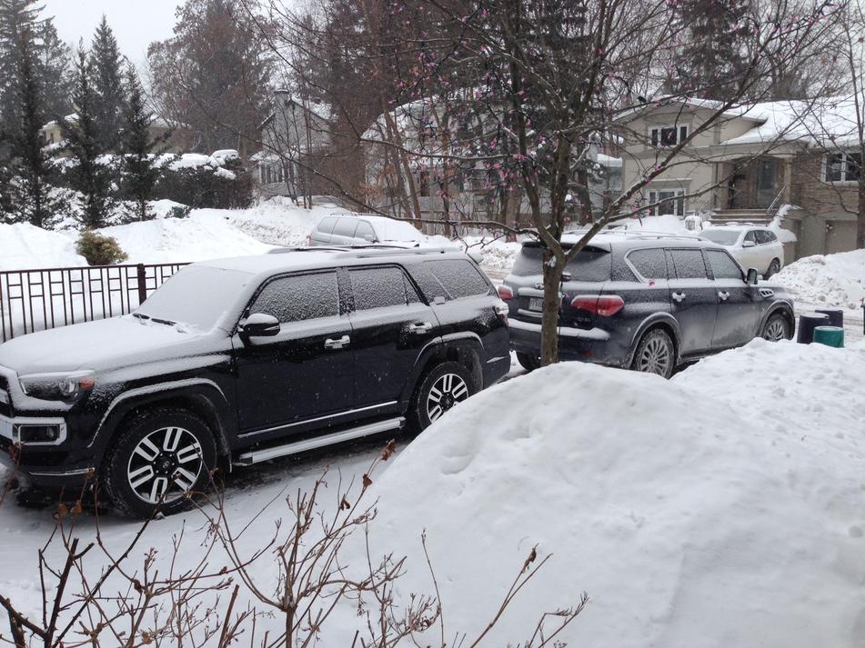

Wait. You want to replicate ride of QX56? So, you're asking to replicate the ride of a palliative Nissan Armada, which is replicating the ride of the palliative F-Alpha platform on the Nissan Titan? Do you need care?
Perhaps you should have bought an Xterra, or a QX80, which is the grown up version of the QX56, and delivers the plusher old timer's ride you so desire. Personally, I would never touch the LE's suspension, and I say so from experience, evidenced by this pic of my driveway just now:
