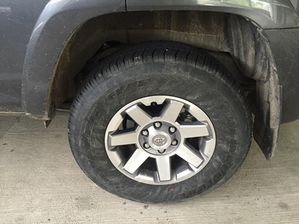

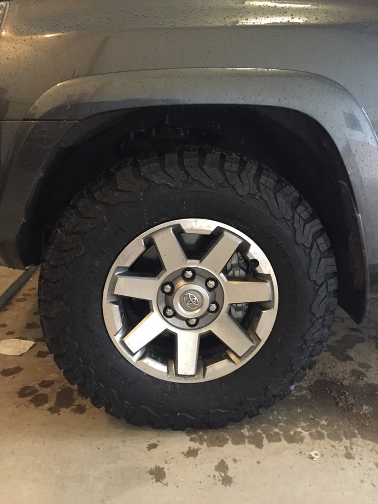

Do you happen to have stock and current pictures of your ride? I'd like to see the difference of the 265 stockers vs the 275 KO2s.
Edit: Found your build thread.
Better comparison

I'm in Denver, and I had the Bridgestones on my 2015 TE. Sold them on craigslist for $400, with 700 miles on them here locally.
Listed as a SL (standard load) tire with 4 ply load @ 36psi
For contrast, BFG KO2s in 275/70/17 are listed as a E1 tire wit 10 ply load @ 80psi
How is the ride with the E load rating vs the stock tires? I'm going with the 265 C load rating as I've heard the E rated tires can be a little harsh.
To be honest with you I haven't really noticed much of a difference. Yes, the tire is heavier, and yes you will have to run it at a higher psi since it is bigger (stock 265 tires suggest 35, with my 275 BFG KO2's I'm currently running 38psi and might go to 39), but I still have the stock suspension and it wasn't as bad of a transition with the new tires as some made it sound like it would be.
Also keep in mind that I'm coming from driving a sedan, so if it was a really rough ride I would be able to tell (in my mind).
Bottom line: not as harsh as anticipated, yet C will be a better ride in comparison. It's all about your desired capabilities!
Sold them on CL, listed at $50 less than TireRack, ended up taking $460. Only had 200ish miles. I have also went to 275 ko2's and come from an 02' Accord. So this is a whole new world for me, as well. I can definitely tell a difference from the stock vs the 275 KO2's, and that was the purpose. I feel like they should feel different, otherwise what is the benefit in changing to a legit AT tire? I'm happy with the size and more aggressive tread and feel they will fit in well with future lift and other mods, go with what you want!
