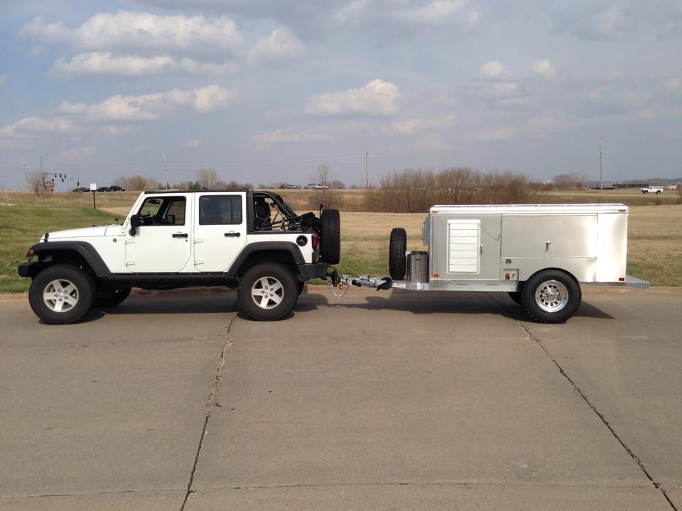

We also have a off-road compact camping trailer with brakes that can be up to 3500 lbs loaded which is too much for the Subaru to pull. So on shorter duration trips we take the Subaru which is a fantastic vehicle both on and off road and on longer trips we take the jeep to pull the trailer. The jeep while great offroad, has been tiring to drive long distances and is not the best tow vehicle. Its so loud on the highway that often by the time we get to our climbing destination we are too tired to climb.

The trailer weighs about 1500lbs empty and is only 4 feet tall and a little narrower than the truck so it doesn't push much air. It usually weighs about 2400 lbs for the road trip and then we fill up w water (30 gal tank) ice and food just before the destination that takes it up to near 3000 lbs.
