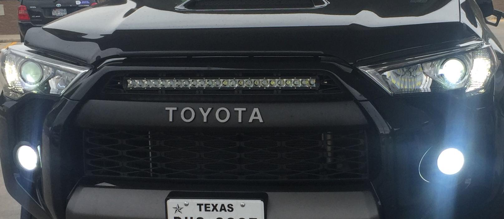

Can you take a photo of the lights on from the front with the white light as well as one with the turn signal on? I really think I want to do this, I hate the orange on with my HIDs and LEDs.
Not the best photo, but you can see the switchback's are on solid white when the headlights (or parking lights) are turned on.
Didn't get a photo with the turn signal on, but it's bright amber, just as you'd expect.

I gotta say, one of the most profound / inexpensive lighting upgrades I made was the purchase of the 1156 LED fog lights. I got them from SuperBrightLEDs.com for $23/ea (part # 1156-CW45-T). These fog lights are bright as hell @ 220 lumens. This was a *significant* upgrade to the crap-tastic stock bulbs. It was pretty tricky accessing them (especially the passenger-side bulb), but was well worth it. You actually get more benefit out of upgrading these fog lights than you will the turn signal switchbacks (although, I DO dig the all-white display).
