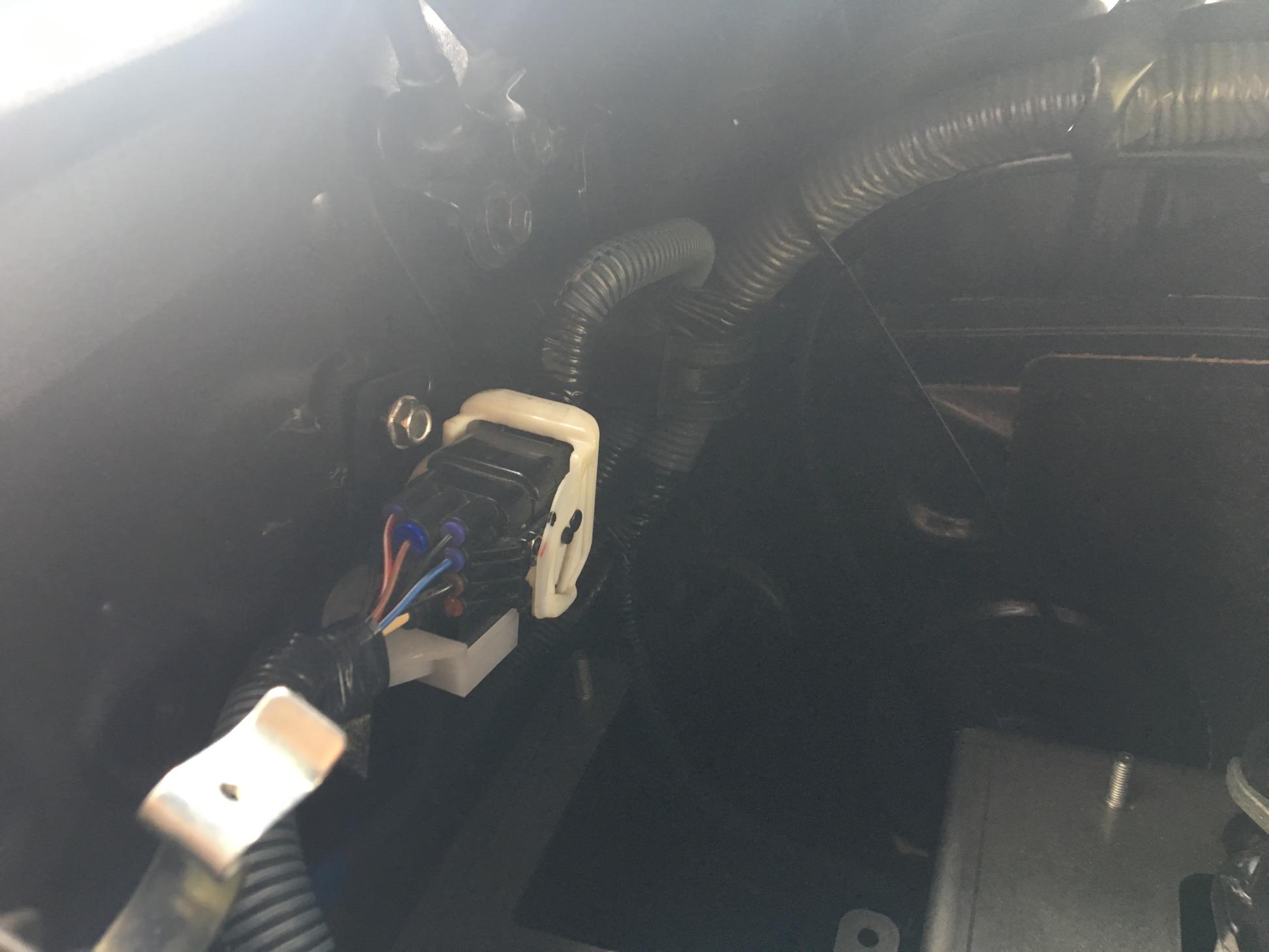

Problem solved!
OBD2 sensor read off a MAF low voltage code. The sensor was fine, turned out it was the connector plug on the fender wall. The white locking lever was in the unlocked position. Simply pushed it up all the way and the car started right up. I will note, the connector plug there was fully, tightly connected. The white locking lever either has it's own sensor or it pulled the connectors together less than a mm to ensure a good connecting. That thing is touchy.
Here's a photo of the connector with the white lever in the locked, correct position for reference. Hope this helps someone else.
