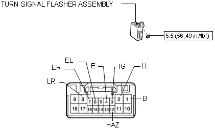

The flasher relay is serviceable although available replacement LED flasher relays (8 Pin) are not compatible due to extra pins for 4Runners that have Auto headlamps (18 Pin). Best bet is to install in-line resistors or modify your current flasher.
I've attached a diagram of the 2010+ 4Runner turn signal flasher assemly.
