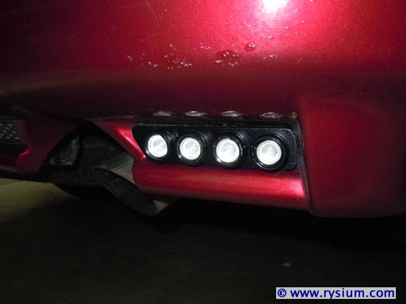

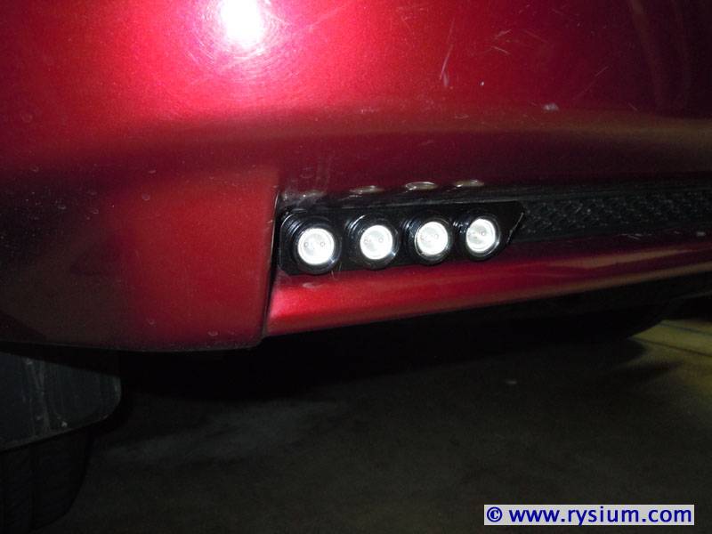

Hey bro, I'm with you :boink: Went through the same pain with my 2012 SR5 that is going to Poland. I ended up with designing and making my own rear fog light . You may check the thread I started some time ago: http://www.toyota-4runner.org/5th-gen-t4rs/204372-2012-sr5-rear-bumper-question.html
The other option I considered was cutting the rear bumper cover and install ready made "reverse-backup" lights (someone did this to his white pearl truck), but put red LED bulb instead of white.
Yes, it is Euro requirement. I got some questions from this forum: "WTF is rear fog light :-)". BTW single legal fog light here looks weird, really like a broken tail light.
I'm not sure if in UK is the same as in Poland:
The rear fog must have the same brightness as a brake light but must be at least 10cm away from tail and brake lights. so using dual intensity tail light bulb does not work.
The other requirement is that it has to be no higher than 100cm above the ground and no lower than 20cm. Because T4R sits high above the ground the 20cm minimum is not a problem, but using tail lamp housing for rear fog will not fit into 100cm limit (tail lamp in T4R is higher than 100cm above the ground).
The last thing is that if single rear fog lamp is used, it must be on the left side (oh, in UK you drive on that side, so maybe it is the right side). It can not be in center. That simple eliminates the option to put the rear fog lamp in the hitch receiver.
So here is my rear fog light (In US I plugged it into trailer plug so they work as stop and blinkers, which is legal here).

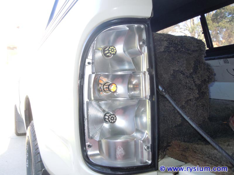

On a couple other places, not this site, I’ve seen where folks have used a Bully CR-007A, the A being the one with a tail and brake light function. They have replaced the 1157 incandescent with a LED 1157. Specifically a JDM Astar Super Bright 5730 Chipset 1157 2057 2357 7528 LED bulbs w/projector, brilliant red. The claim is the tail light function of this LED bulb is about the same brightness as the brake light function of the incandescent. Thus with the tail lights on this light supposedly would be as bright as a brake light.
Are there any thoughts on this LED bulb or another LED bulb that might be even better?
I have JDM Astar 1157 in my 95 Tacoma as a stop/tail bulb (actually I have all bulbs JDM Astat in my tail lamp)
While they are indeed very bright, visually the same as incandescent bulbs, but they have a small flaw in the design. They have a small current leak (reported not only by me, but by other buyers) from stop light circuit to tail light circuit. What it means, when I step on brakes the tail light circuit is powered through brake lights creating all kind of strange things: dash lights came up, front markers come up, the door open warning chime sounds.
95 Tacoma is very simple comparing to 5th gen 4R - it doesn't have Body ECU, so back-feed power did not do anything bad to the truck. I don't know how Body ECU in 4R would behave if it is powered from the receiving end - it may be even possible to fry something.
Now my JDM Astar bulbs are the older version (AX-2835 Chipsets), you may have better luck with new 5730 Chipsets version. I fixed my problem by adding a diode in taillight wire because JDM Astar did not take the ownership of the problem.

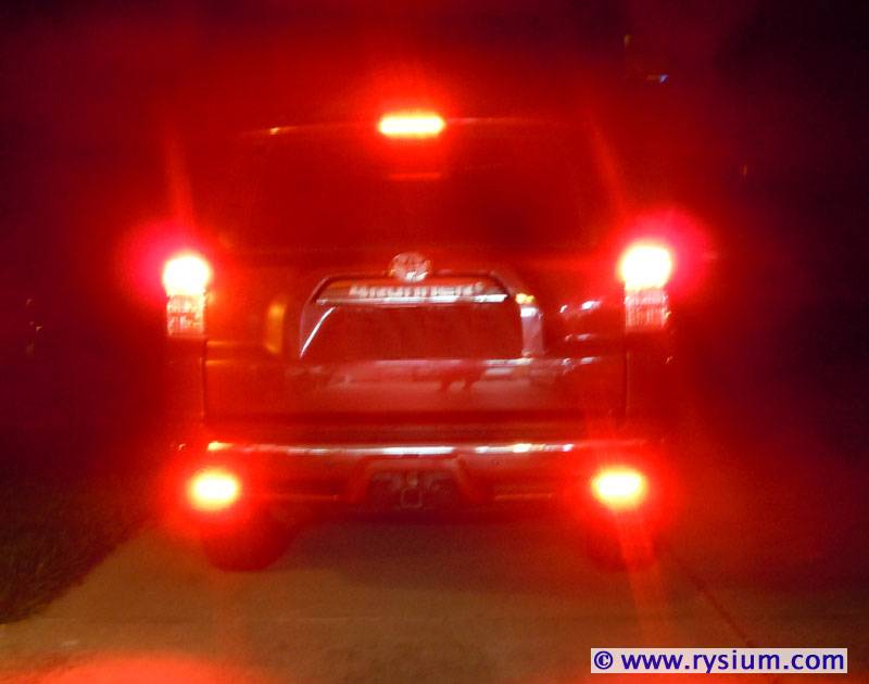

BTW, my coworker who was tailgating my 4R on the way to the office this morning asked me about my "aftermarket brake lights", they were so bright and very visible (it was a day time). So I guess they will pass easy as rear fog lights. And even if we had car inspection in California, they would easy pass as working brake lights too.
