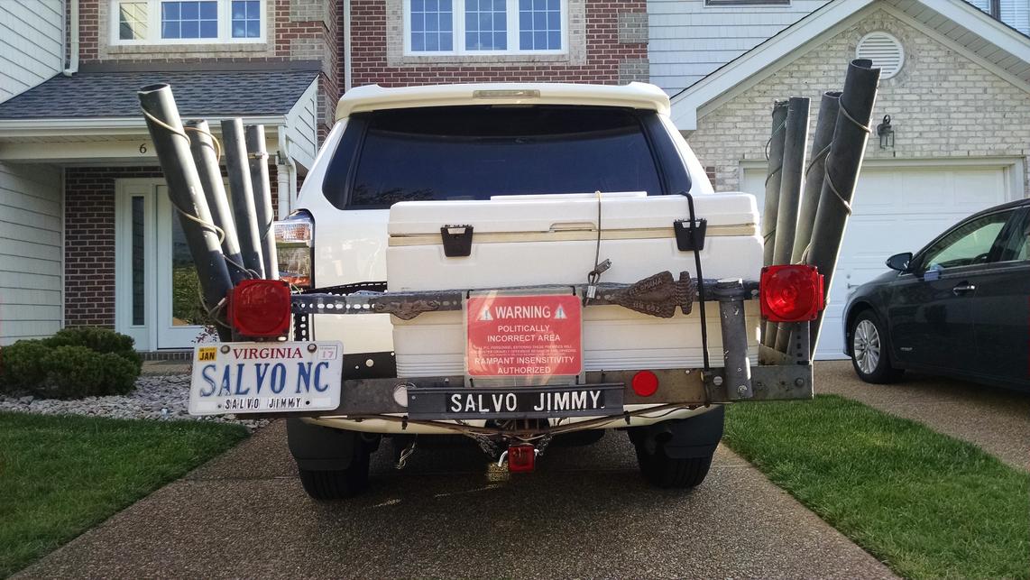

Thanks, Someone had put me on that thread earlier, but I was just looking for something simple without all the wiring, switches, cutting, etc that could use the trailer connection and be swapped from hitch extender to stock hitch when my rear fishin' rod / cooler rack was/wasn't on.
The setup with the rewired Bully gives a very visible red light, but not blinding, and it does not violate any light law in VA or NC where almost all my driving is done.
Here is pic with rack on

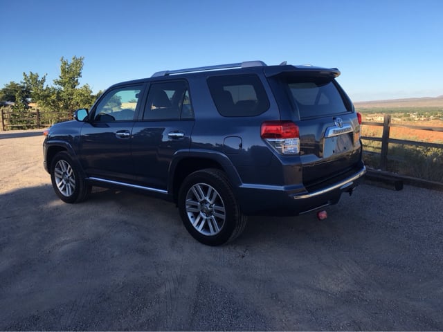

So I think I need this. Basically, my 11 T4R was originally purchased overseas and I'd like to do this to replace the low hanging drivers side light that was installed on mine.

Hi Jimmy - I want to do the same exact thing as you did. How did you rewire the extension to the bully?
i
I just cut off a bit of insulation on the tail light wire on the extension, cut the brake light wire and attached it to the tail light wire where insulation cut off. Taped everything up good. No problems since 2016
