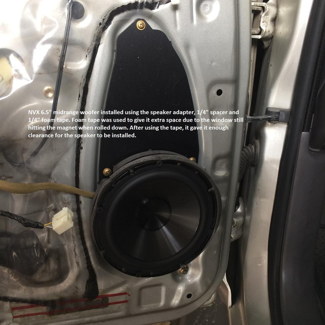

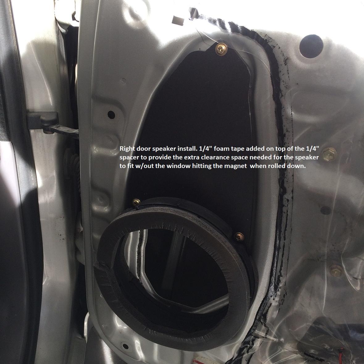

Sorry don't have any info to help you out regarding your speakers but just a quick suggestion for you, try out PVC Speaker Adapters - CNC Machined - In Stock or Custom Made. I've purchased from them before when I bought some 6.5" component speakers up front. They specifically make speaker adapters to fit your vehicle and speakers. The PVC mold they sell for the make and model of your vehicle is the same shape and size of the stock speaker housing so you don't have to worry about the universal speaker adapters not fitting correctly or the screw holes not lining up perfectly. Also, they sell extra spacers from 1/4" to 1/2" thick just in case the speaker is too deep to fit inside your doors.
The pictures I attached shows the products I purchased from his site. Can't say enough great things about his products. I will be purchasing more of his adapters in the near future for my wife's speakers and for when I decide to purchase new speakers for my rear doors. Plus, he'll refund 1/2 your purchase price if you send him at least a minimum of 10 pictures showcasing your speaker installation using his products.
