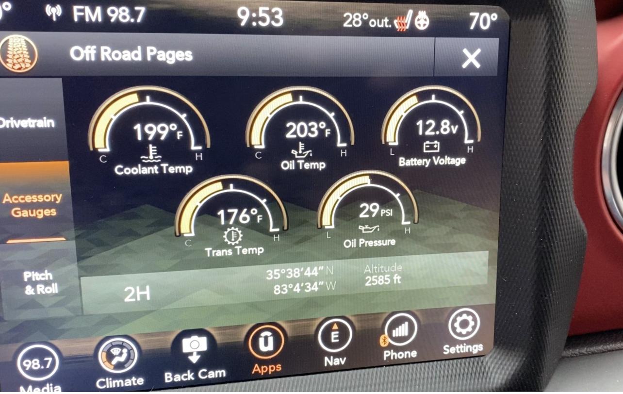

One of the only things I miss about my '20 Rubicon over my '20 4R ORP is how great the Jeep user interfaces were on the infotainment, navigation, etc. This Toyota system is awful and maybe a decade behind in comparison.
