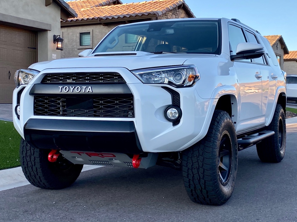

Yeah it’s apparently on back order but it still managed to show up at my door within a couple weeks. It’s easy enough to install yourself and fits perfectly. The cheap aftermarket parts are not yet available. For OEM quality though, it’s worth the price.
Part numbers and where to buy:
Garnish Front Bumper - Toyota (PZ323-35058) | Toyota Parts
Grille Radiator Up - Toyota (PZ327-35056) | Toyota Parts

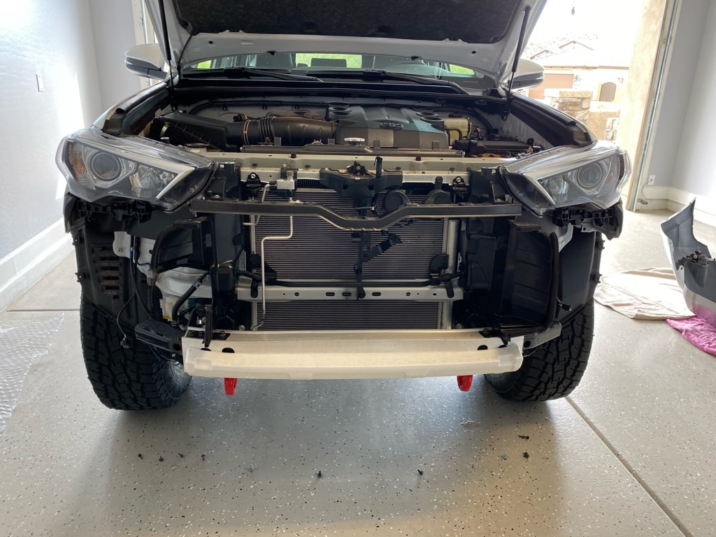

I'm just a little nervous about doing the install with the new TSS sensor. Any issues with that?

No problem with TSS if you order those two parts. The new garnish has a 1/4” notch around the TSS sensor and doesn’t touch it. It also helps you align it straight so it’s a win-win! The hard part is getting your upper grille off. Watch a couple videos on heritage grille replacements and you’ll see it just needs a little more force than you would comfortably apply to a brand new car haha. It just pops straight out. There are actually a few tabs in the upper grille that you push on to make it come out a little easier.

Yes, It's the OEM garnish and upper grill. Also OEM valances front and back.

The valances required me to remove both front and rear bumpers. I figured I’d do the grille and valance at the same time with the bumper off. Valance replacement was super easy.. it’s just clips. Taking off the bumper requires a few extra steps with the TSS disconnect but overall it wasn’t very difficult. YouTube videos helped for sure.

No KDSS here. The grille and garnish was a pretty straightforward install but it was easier with the bumper off. I’ve read in the Chinese grille thread that the radiator bracket needs to be replaced. I can tell you that if you buy the ORM parts you won’t have any issues with the bracket.
It took me 5 hours to remove both bumpers, replace the valances and grille. I’m not the fastest when it comes to these things though. I wasn’t in a hurry!

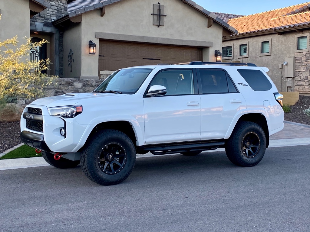

I just got a 20 ORP. Trying to decide on my lift/tires plans, and your rig looks like the perfect setup. What did you end up going with?
Sent from my Pixel using Tapatalk
I went with the 6112’s in front and 5100’s in the back. Icon springs. Stock UCAs. I didn’t have to do a body mount chop, just pushed the fender linings forward. I’m really happy with the height and the ride is awesome.
Lots of tire choices out there but I ended up with the Toyo Open Country AT IIs.
