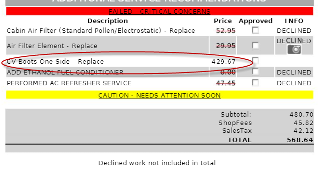

I took my 2020 with 10K into the dealer yesterday for it's second oil change and 10K service. I'm a little disappointed with the outcome and wanted to ask a couple questions. I didn't get charged for anything but did get an invoice that said
CV Boots One Side - Replace $429.67
When I asked about that, they said one was damaged and they were going to replace it but when the technician looked at it, it just needed to be tightened. "everything is fine" I was told.

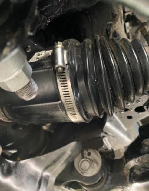

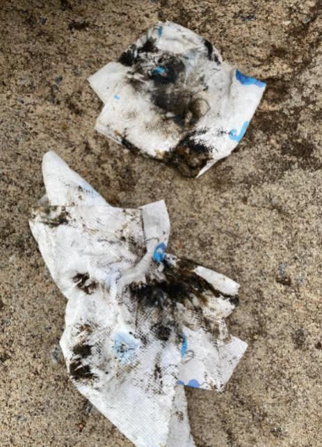

I took a look at it today and saw that they put a hose clamp on it to tighten it and that there was grease around it that had flung out that wasn't cleaned up. I've hosed it off and cleaned up what I could, but I feel as though they took a shortcut, didn't even bother to clean around it, and now I may be in a situation where it'll give me problems in the future. I'm pretty sure they didn't repack it with grease, I can ask though. I should have looked at it before I signed for everything. I'm disappointed about just using a hose clamp honestly too.
I've included pictures, but I'm wondering if I should go back or say anything. I'm going to keep the truck a LONG time, my previous 4Runner had almost 300K on it, so I'm committed. If there are toyota techs on this board, I'd like to get their opinion and also ask what I should do as a customer. I don't want to be the pain in the ass customer that pisses them off, but I also don't want it to be a problem in the future. I've got a lifetime powertrain warranty but I just don't want problems in the future.
The invoice is attached, along with the pictures of the boot and the grease I cleaned off. The air filters are simple to replace and I already have myslef, I won't pay $80+ to have them do it. I feel like since it's on the invoice, they will get reimbursed from Toyota for it and they didn't really do what is on the invoice.

Jesus Christ you’re under ****ing warranty. Take it back and make them do it right. If THAT fails they aren’t going to warranty it because it’s not factory and it’s not even RECORDED as work having been done by the dealer.
You'd get fired in my shop for trying that stunt. Take it back. It will now likely need a boot from the damage it received from the hose clamp. You may want to find a new dealership.

That is a shit job done and whoever thinks that that is fixed should be fired or sent back to the quickie lube bay with a spanking :ybrick:
I would want a proper OEM CV band installed. They are supposed to be oetiker clamps

I keep a spare boot kit in stock 04427-60131. They are like $45 and have all of the bands, inner and outer boots, plus grease. Not sure what the size or part numbers are for the bands individually.
Mechanic may have broken the OEM band if they didn't use the proper tool. He probably didn't tell anyone and may have installed a used hose clamp. I would go back and ask to speak with the shop foreman. Tell him your invoice doesn't document the improper repair and you could be denied a warranty claim in the future because the dealer will think that you installed the hose clamp.
The CV joint grease doesn't have to be changed or "topped up". The amount you show on the two rags is not enough to merit any concern.

Hose clamp? That's excessive vibration waiting to happen. Like the others said, take it back, show the service manager, and make sure they fix it right. I had to have a boot replaced on my wife's Volvo, and didn't even think about doing it myself, since I didn't have a tool for the appropriate clamp.

i had the exact same issue on my '19 with the inboard passenger CV boot throwing grease due to the clamp being too loose, at about 17k miles. my understanding is that apparently this isn't too uncommon.
"this should be an easy fix" i thought, stupidly. took it to my local dealer for what was clearly a warranty repair.
- first time back to the dealer, new clamp installed and then immediately began to fail again about 100 miles later
- second time back to the dealer, new clamp installed and then failed again about 500 miles later, and while checking the boot i noticed whatever assclown technician reinstalled the lower control arm castle nut, secured it the way you'd tie up a bag of bread with a paper clip.
- third time back to the dealer, new clamp installed and failed again in about 300 miles.
you see where this is going. at this point i'd had enough, i don't have time for this kind of circus and we need this vehicle running, not in the shop as its used every day for work so i went ahead and got a stainless steel, rolled-edge screw clamp (which has been successful for many other T4R and FJC owners) which installed in about 4 minutes and in the last 3k miles it hasn't had a single issue.

Talked to the service manager yesterday and showed him the pictures and the invoice. He realized they didn't do right. He talked to the service tech to get some more info and came back and asked me to drop off my 4Runner at my convenience. Told me that clamp should have been a temporary fix as they were out of the correct one and they should have told me that.
They ordered the correct clamp and will make sure the CV joint is good, lubed correctly, and will replace the clamp with the correct one. They called me this morning and told me the clamp had come in and I've made my appointment.
They made good. I wish they had done that at the beginning, but they made good.
