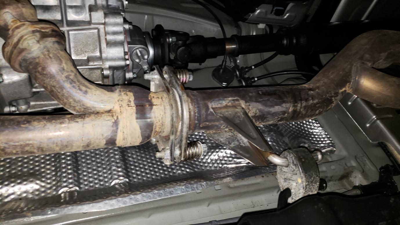

Found where the noise was coming from.
The exhaust pipe rattles or shakes when transmission seems to be in drive or engaged, I am not sure where they are making contact but I held the spring portion while my wife was shifting to D to N to D, noise seems to not happen.
The weather being 95 F constantly in California is also seems to making things worse. During the night time when it's 80 F, noise happens for brief second, which I think it's the normal procedure.

Sorry for super late reply. I didn't take it to the dealer because I honestly think it's normal behavior with a factor of hot weather (95F+ summer).
I did tighten the spring bolts to whatever I can and just haven't heard it since. Plus weather is cooler now too.
