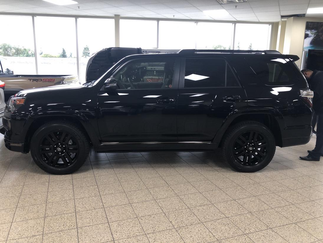

Hello again. Just picked up a limited nightshade. Love it except for the stock tires. I would like to move to a slightly more aggressive wider tire I live in calgary Alberta so want it to handle all seasons wondering if I should do a levelling kit or small lift to make room for the larger tires. I’m not looking for anything over the top just subtle that makes it look a touch more off-road Not sure if the level or lift is even needed so please chime in. Also if you can recommend a slightly larger / wider tire size it would be appreciated.
Here’s a pic

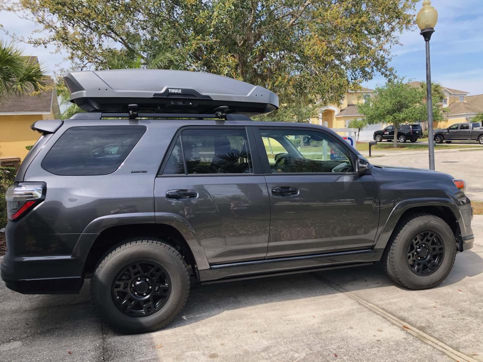

If you only want wider tires you can go 265/70/17. Here is my Nightshade with winter tires on 17x8 wheels.
