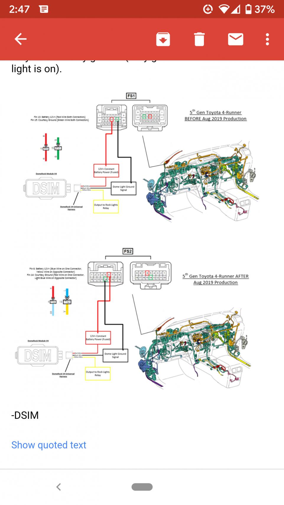

Long time lurker, this is my first post. I am trying to wire rock lights under the truck. I made my own harness and tested everything. I can turn the lights on and off with the spod touch screen. I am trying to get the lights to turn on and off with the dome light. The wiring has changed from the 2019 and the 2020 models. Diagram shown. I used a crimp tee connection to attach to the wire in the diagram. When the dome light is on I am showing continuity from my connection to a grounded bolt. When the light goes out I lose continuity. The voltage also drops to zero with the light out. I have an spod bantam and it uses triggers to activate the rock lights. The jumper is in the correct position and I have spoken to spod over the phone for help and couldn't resolve the issue. Thanks .

The light never turned off I waited 5 minutes after the dome light goes out. I tapped the yellow wire from the diagram above located in the driver side pillar. It is different from the tutorial but it should be the correct wire.
Figured it out. I couldn't find the wire that I need at the harness. I kept reading continuity and the light wouldn't turn off. I took the mirror apart and found 2 yellow wires going to the puddle light. Then I traced the one I needed inside the door panel and made the connection there. From there I followed the wires from the harness through the sleeve going from the door to the interior behind the kick panel. Next, I ran the wire through the grommet in the firewall to the spod. I had to set the jumper on the spot to POSITIVE. I have tested it 100 or so times and it works. Everything else works fine so far.
