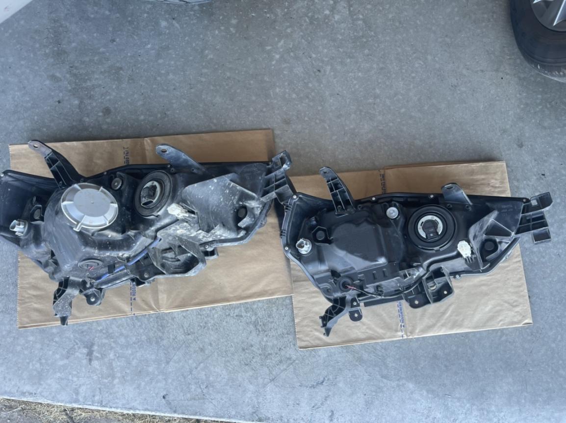

The housing on the left is the 2014-2020, the low beam is behind the gray cover that comes off. On the 2021+ it’s sealed.

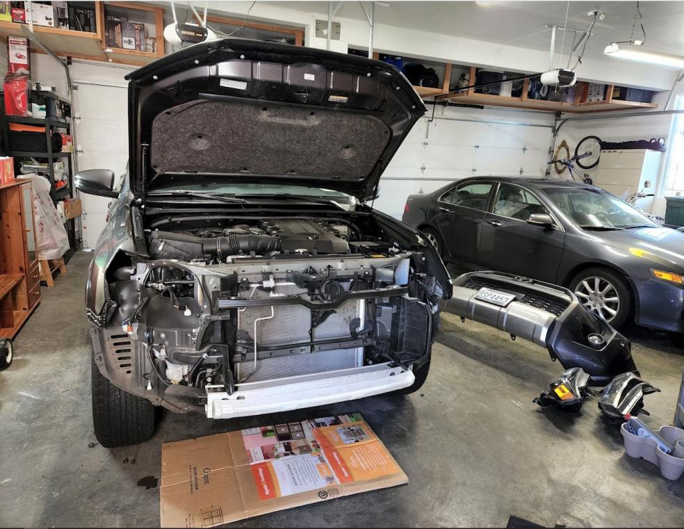

Did this today!
Took about about 2 Hrs. I have a 2020 ORP. Time it test it now.

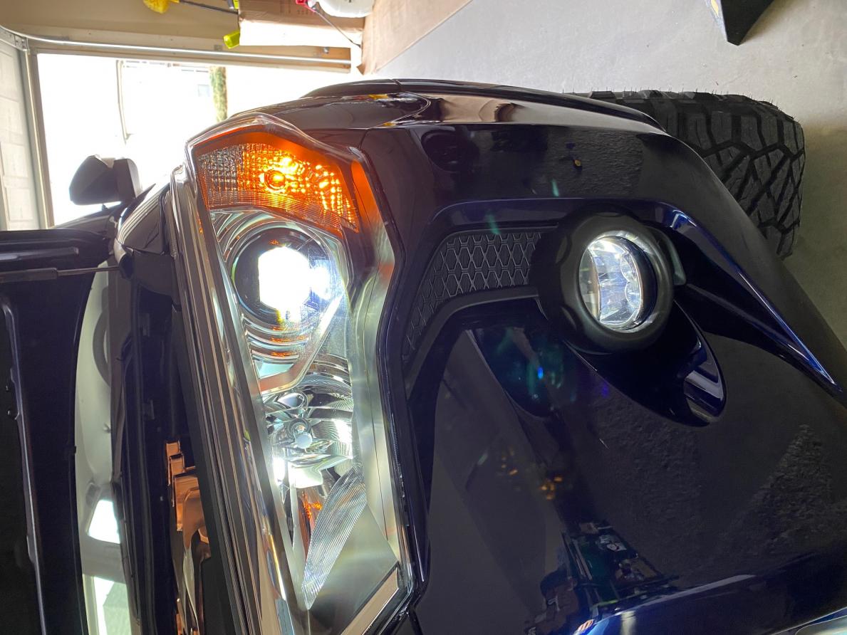

Best upgrade ever. Night and day vs drop in led kits and 0 glare vs the hid kits. l
