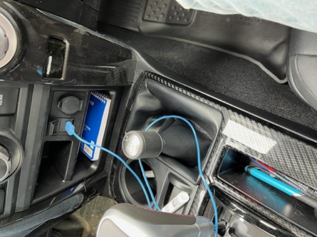

Has the transfer case shifting now gone back to mechanical? Truck is one week old and I’m seeing and driving it for the first time today.
The OR, ORP and Pro’s have the 4WD shift lever as you have shown. You have a rear locker to boot. Much more capable off road. Good choice.
Thanks. Yes it’s an ORP and that was by design to get the rear locker. Just assumed they all came with the selector switches.

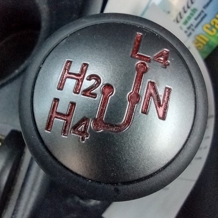

I have a 2020 TRD Off Road Premium and it has the lever shift for 4WD. My problem was that the lever knob is facing away from the driver, it would be better if it was angled towards the driver so that I can read the knob top indicatiors better.
I partially solved the problem by putting paint on the knob to make it stand out more.

its a pretty simple shift pattern. Most people probably aren't looking at it while shifting

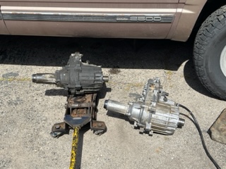

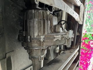

I just rebuilt an NP 241-C transfer case and used it to replace the leaking one in the ‘94. Not too hard of a job:
