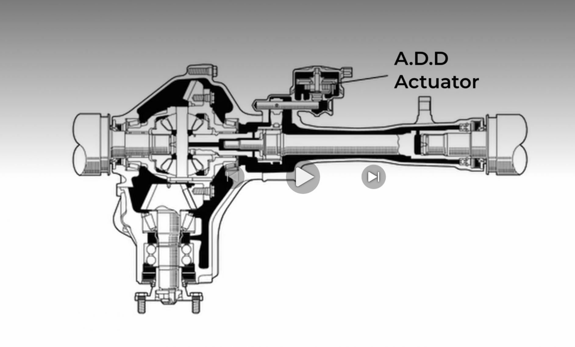

Would it be more accurate to say the ADD actuator engages the front drive shaft to the front diff., and not the front axle to the front diff?
No, it would be inaccurate to say that.
The ADD (Automatic Disconnecting Differential) actuator engages the right (passenger side) CV axle which is always spinning when the vehicle is moving, to the front differential, which then allows the power coming from the transfer case (after it is shifted into 4wd) through the front driveshaft (or Propeller Shaft as Toyota refers to it) to drive the front differential.
The left (drivers side) CV axle is always spinning when the vehicle is moving. But it only spins the spider gears (or side gears as they're sometimes referred to) in the front differential when the vehicle is in 2wd.
reason i ask, mine is on jack stands, all 4 wheels off the ground, and i was able to spin the front driveshaft freely without anything moving up front, cv axles or diff. Which means the driveshaft is not connected to the front diff when in 2wd
It means that the pinion was spinning the ring gear, and the side (spider) gears were rotating around the stationary gears attached to the left CV axle, and the shaft coming in from the ADD on the right side.
If you had ever had an open differential apart, or assembled many of them as I have, it would make sense.
Yeah, differential operation is probably one of the more difficult things to visualize, IMO.
this helps
No. The left CV axle only spins the side (spider) gears in the differential. As I said in post 31.
The driveshaft (propeller shaft as Toyota refers to them) between the T-case and front diff is stationary in 2wd.
