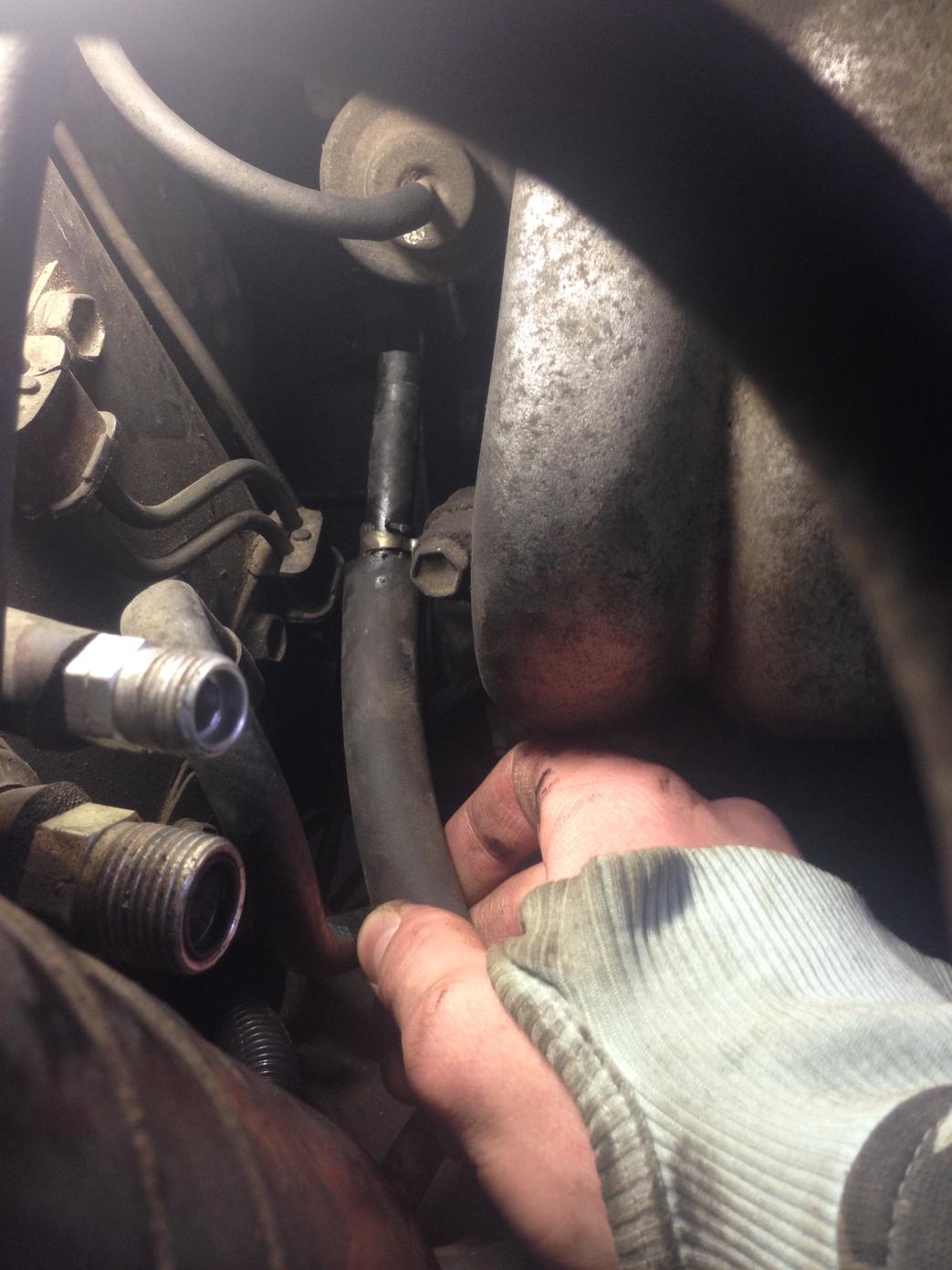

I unplugged what I believe is the the fuel rail line and I cranked it for a good 5 seconds and nothing came out of the hose. Was this the right line?

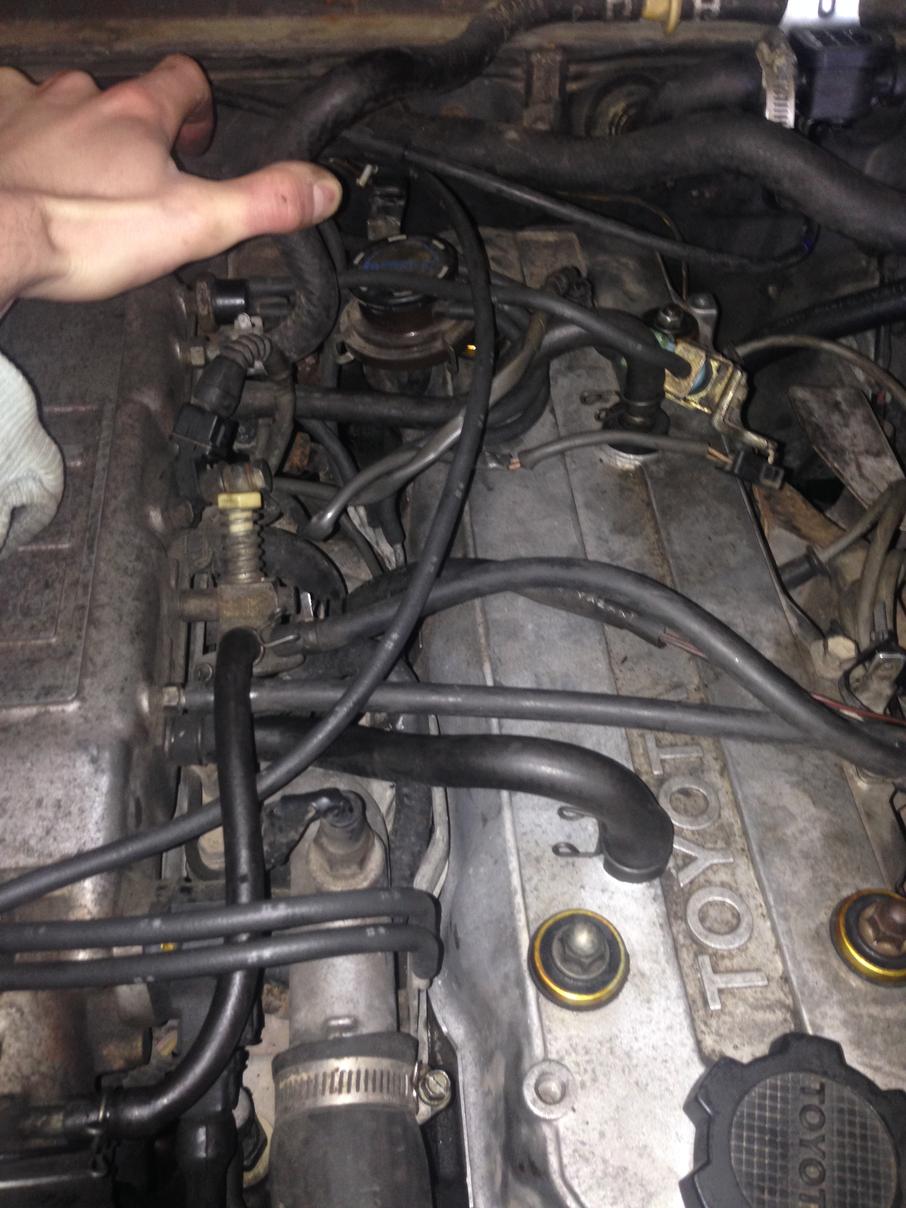

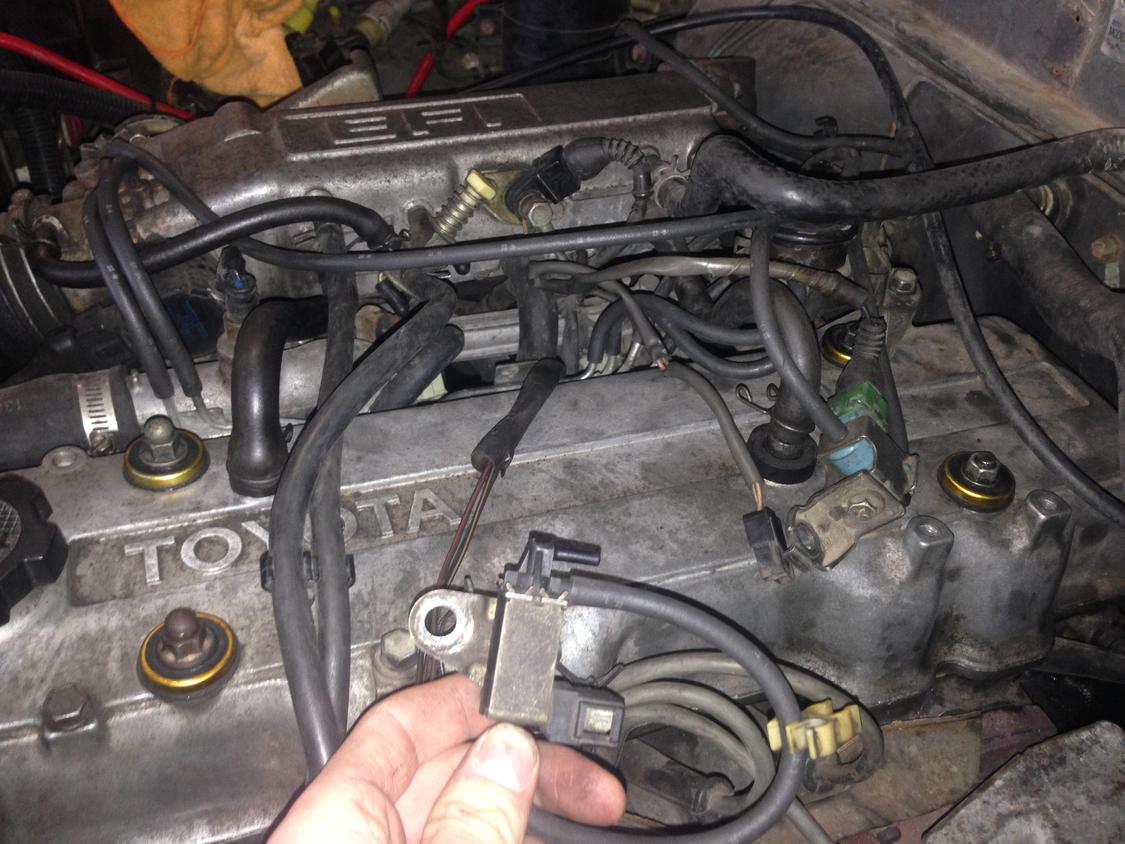

Here is my hose set up. I'm sure you can't tell much but if you see anything wrong let me know. From diagrams I have been able to find and looking at 4crawlers hoes swap, (p1020528)
I moved a few around and eliminated the black piece that I'm holding in the 2nd picture. I don't know exactly what it is, but from 4crawler's pictures, it looks like it could be something to do with the AC (which I eliminated last winter). No matter what I do to the hoses though, it still does the same thing. It is sooooo close to coming to an idle, but if I hit the gas it does completely. I'm really hoping it's a clogged filter now.

All your high pressure fuel lines have banjo fittings. I think what you found there is an emissions line or fuel return.
The fuel line comes up the frame rail and goes to a flexible line with a banjo bolt on one side of the fuel filter, then comes off the fuel filter and ties in at the front of the injector rail. Front of the motor, between the upper and lower intake plenums.
