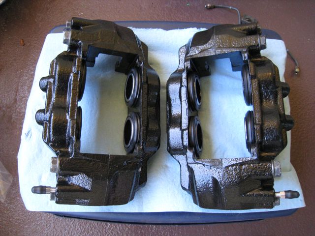

Yep, this is what I did. Paid $15 each, no joke. Just finished restoring them last weekend--cleaned, rebuilt, SS speedbleeders, and hit with a coat of black G2 to keep the rust off. Going to nab new pads and rotors later this month and finish the install.
That said, I'm not sure I'd recommend it unless you've got a proper wire wheel handy. Cleaning them up with a Dremel was a long pain in the ass, and when you add in the rebuild kit, paint, grease, speedbleeders, and misc supplies, I'm probably $120 in for a pair of unwarrantied calipers. Remans aren't that much more, and certainly less hassle.
But hey, I did it because I wanted to tinker, and that's worth something. Search around on Car-Part and see if there's anything local.
