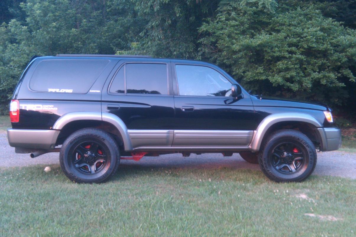

I'm thinking of doing my Tundra calipers in red for this exterior color...
IMG_2261.jpg~original
Any opinions?[/QUOT
Go for it! I like the way mine turned out, tho i did more then just the calipers- also really like the way LINY did his wheels..
