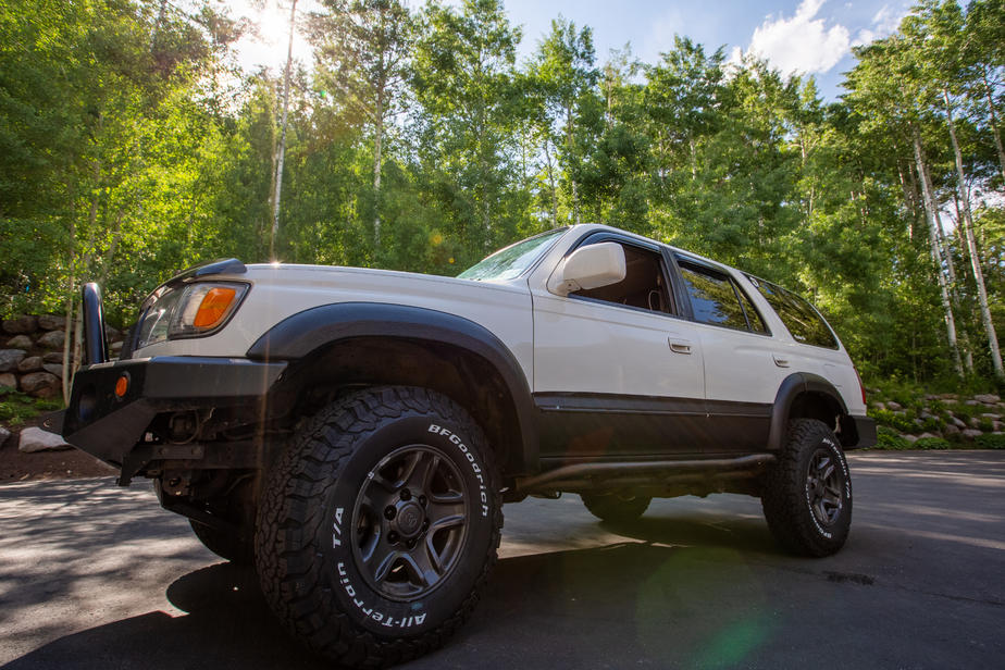

I wanted to update this thread. After a lot of soul searching, self-doubt/pity, research, and general time wasting, I decided to go with the 235s in the BFGoodrich KO2 flavor. They made the stance look a titch narrow, so I threw on some Spidertrax 1.25" spacers that really helped(photo taken before I mounted the spacers).
So far I really dig the way the truck handles. I think its a big improvement over the stock size all around and really helps out the 3" lift, while only adding 9lbs over stock tire weight. Highly recommend.
