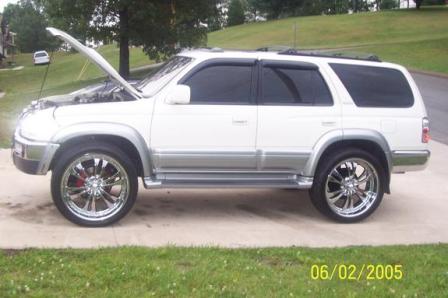

24's on 3rd gen...
I don't think there is anything wrong with going for a big wheel. Some like to go off-roading and some like it on the street. I run 22's on a lowered suspension and have no problems. As far as handling, I recommend upgrading your brakes to a tundra kit to help stop. However, to answer your question if you were to do anything larger than 22's the tire's sidewall would barely protect the wheels from any damage. BUT it can and has been done. Check out my signature.

The problem still exists of problems of early wear and tear and the stress and weight of big wheels on the hubs especially if you paln on putting alot of miles on your truck.
If you are just goign to keep the vehcile for a few years you won't be dealing with any issues but if you plan on driving your Runner shod with wagon wheels for 100,000 miles you will pay for it. My friend is a Toyota mechanic and he's seeing alot of older cars/trucks coming in with premature wear on wheel parts associated with big wheels.
I do find the combo of 4wd and big wheels is an oxymoron since the big wheels cancel out any real effectiveness of the 4wd.
Kinda like showing off your cool hunting knife but can only spread butter with it. :p
Yeah, those 24" rims are kind of like clown shoes on the car. It might look better if the 4Runner wasn't such a narrow vehicle, but since it is taller than it is wide, it just looks like a rollover waiting to happen.
Plus the stock brakes are overtaxed and there's failure potential and not to mention the stress on the stock hubs which will lead to premature wear and replacement of said parts. IMO the look isn't worth the wear and tear and the sacrifice of nearly every performance aspect but it's the individuals choice to make that decision.
I wouldn't go bigger than an 18 on a 3rd gen if it was just for the street only or at least do the brake upgrade for safety reasons.

Sheezy's wheel tire combo is considerably more heavy (chrome plating isn;t light) than what came stock plus the hubs arent' designed to have that large of wheel connected to them and there is more stress directly on the hub.
I'm betting 22"s adds over 60-80lbs per corner and when it becomes rolling mass then it's even heavier.
My friend is a mechanic for a dealership and he's seeing more people having to have hub related parts replaced much sooner than is expected and it's people with oversize rims on their vehicles when they came with 16" or so from the factory.

I would not consider cross drilled rotors an upgrade. you have less stopping power and are prone to stress cracks now. cross drilled should serve you fine, but i don't see any advantage.
