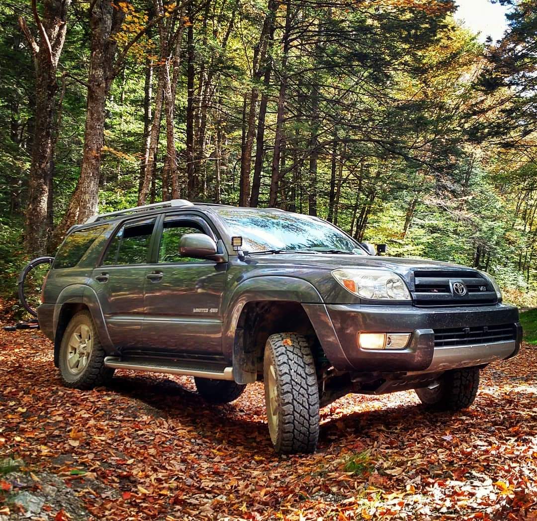

What size lift are you running? Looks clean
Thanks
Front
Bilstein 6112 - 1 down from the highest setting
1/4" spacer on driver side only
Rear
OME 2895 Rear Springs
Bilstein 5100
After lift (unloaded): Measurements in inches, measured from center of rim/hub to fender
Front = 22.5"
Rear = 24"
