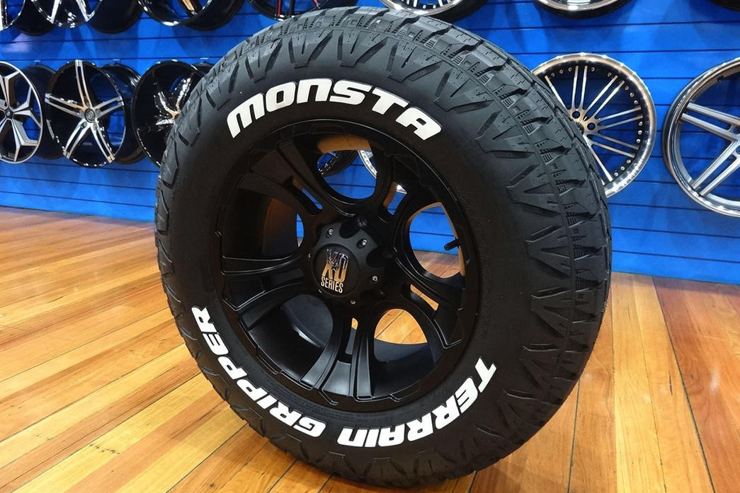

ive tried load road range E tires and a few other kinds on my V8 4runner and the LR E tires were by far the worst handling/driving ive had. I now run 265/70/17 Monsta Terrain Gripper tires on my fuel D583 rims. I imported them from Australia so no one else probably has these but i absolutely love them.
Added a pic of the tire.
