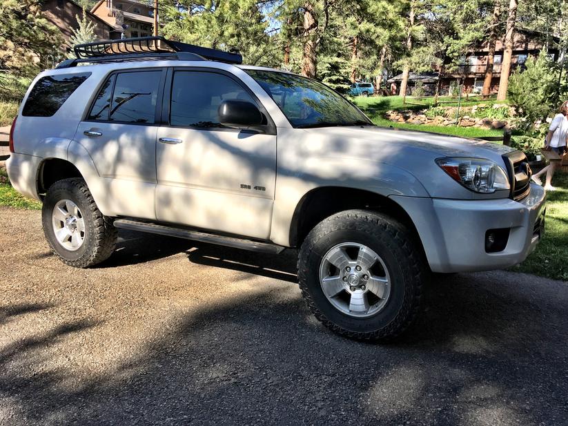

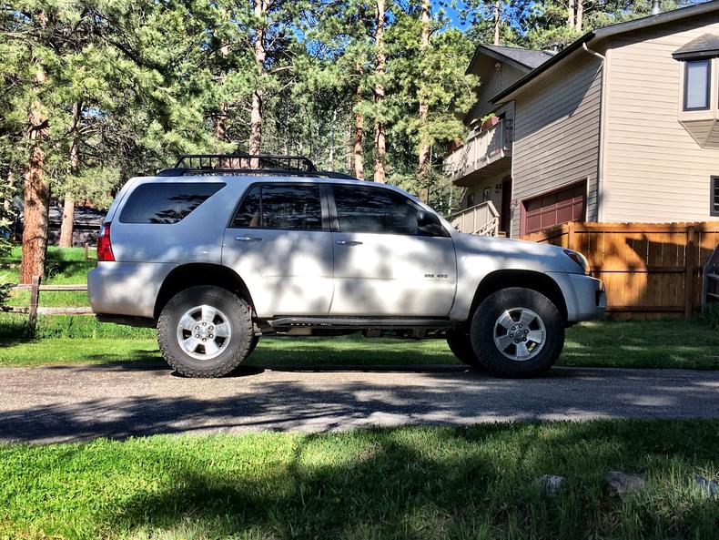

Fit without rubbing, at least without the mud flaps. Spare fits but just barely on the V6 with tow hitch and doesn't rub on the panhard bar at full pressure- discount tire got it to fit just fine. Stoked!

I'm going to copy your choice on size and brand...I'm glad they fit!

It seems the BFGs are a little bigger than the Coopers at 33.1 vs 32.8". The wheels probably also play into the rubbing. On my previous Tacoma I ran 255/85r16 Maxxis tires which were 32.8" on stock wheels with no rubbing, so I thought I'd go for the "short" 255s again. Plus the spare tire was really tight with a 255/75r17 so I was nervous about fitting a 33 without hitting the panhard bar.

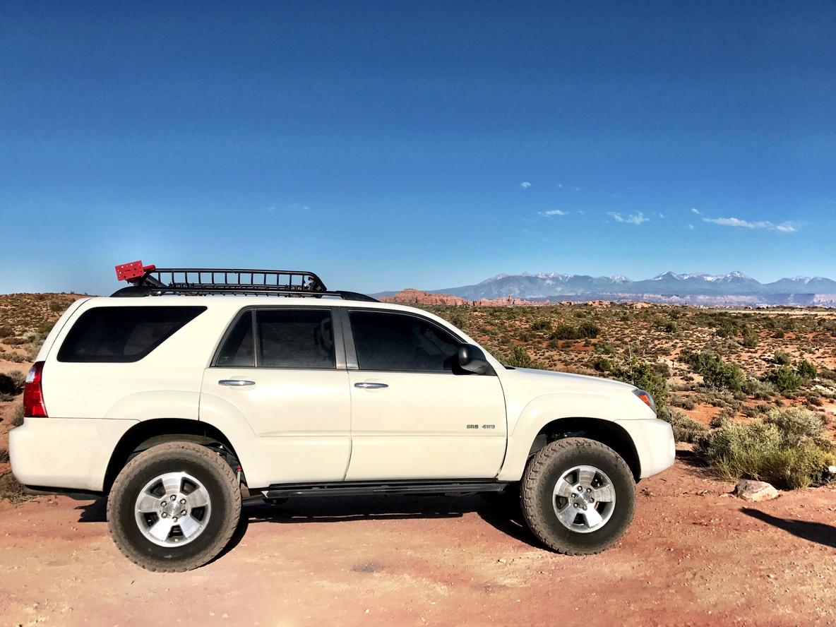

I should mention that I have a 3" lift with LR upper control arms with 3* caster to help push the wheels forward. But still no rub even stuffing the wheels, will put the mudflaps back on when I get home

OP- 4runner looks great, what sliders do you have?
Thanks! I have RCI's sliders and have been very happy with them. All the bolt holes lined up perfectly and they let you adjust them up and down for your preference. I got the treadplate and they also work good as steps. They've taken a few big hits without issue. Would strongly recommend them!
