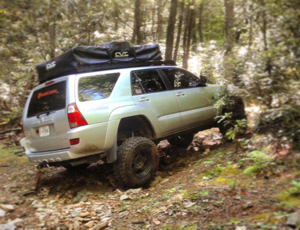

255 all the way. I know it's a 4th gen, but these are 255/80/17s... which are the exact same height and width as a 255/85/16
Perfect in every aspect of all around off roading
