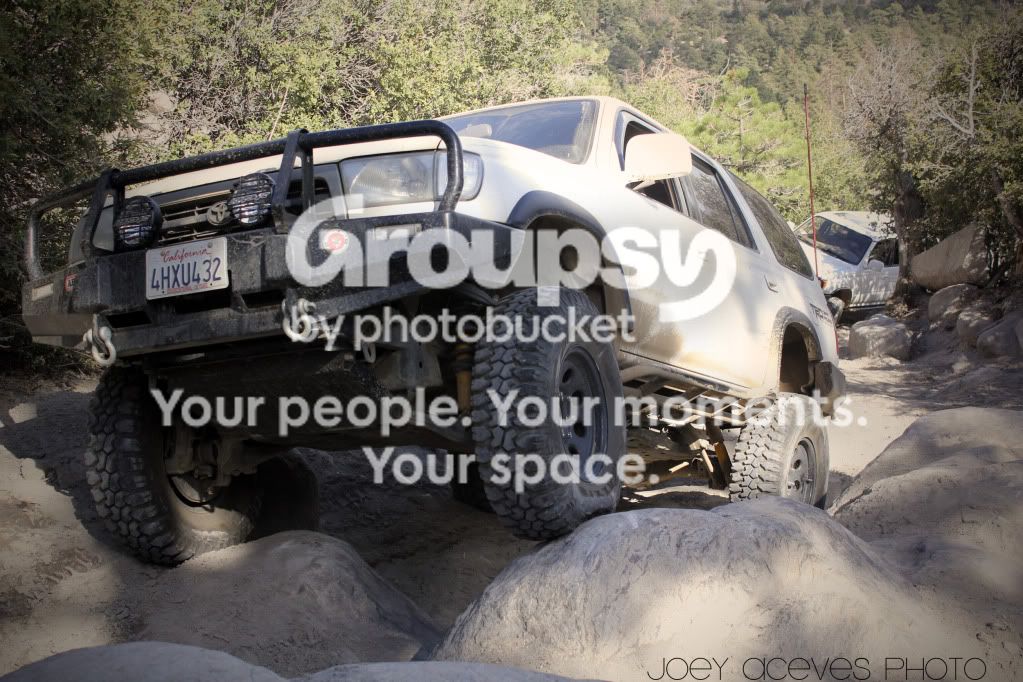

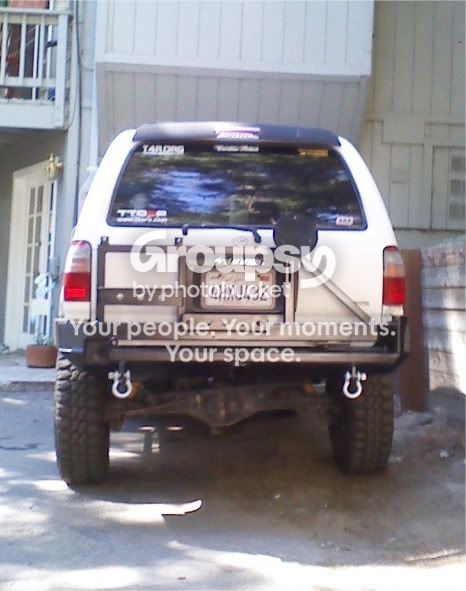

Brian do you or anyone for that matter have some good pics of those 255's on your rig? I wana see how skinny they look.
Sure, here you go...
cbiandhilift.jpg~original
1015101800a.jpg~original
IMG_15781.jpg~original
0913101039a.jpg~original
Arg!! Can't wait to get mine on!
