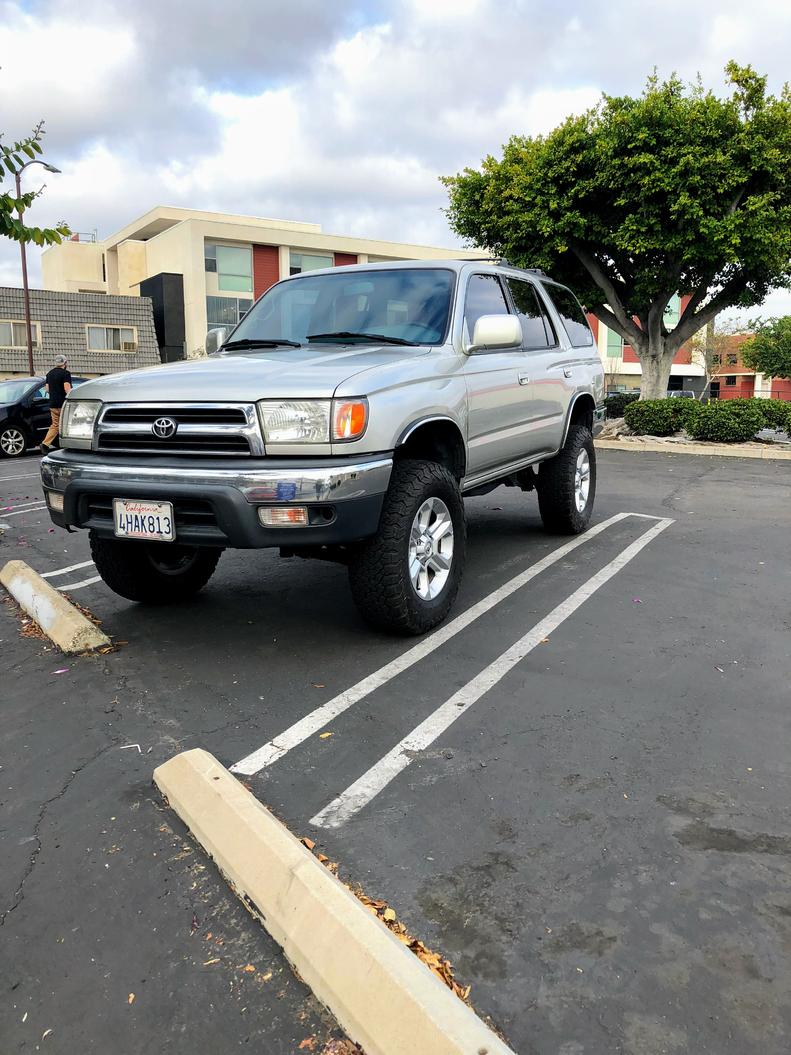

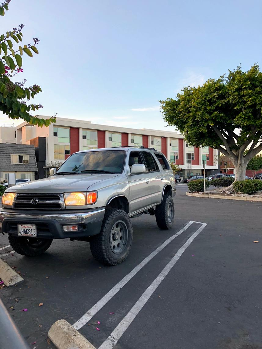

265 70 17 wheels on 7" wide +14 mm offset (stock) wheels vs 8" wide 0 offset. same tire.
I spent some time trying to find some pics on this before i got wheels. and couldn't find much.. so here is my first real contribution.
I hope this helps someone in the future.
"stock" set is off 2016 ish SR5 4runner. Same specs as soo many 4 runners stock wheels
others are American Racing Mojave 2 Teflon...
