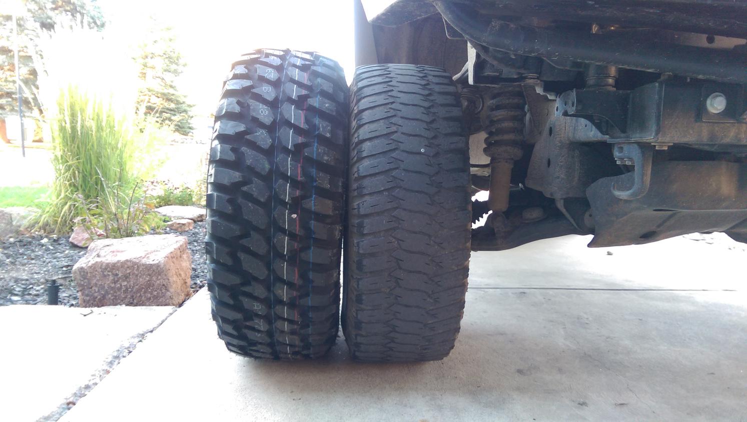

Here is 285 vs my new 305s. Now tell me there is no advantage, LOL. Larger tires just make it easier offroad period.
