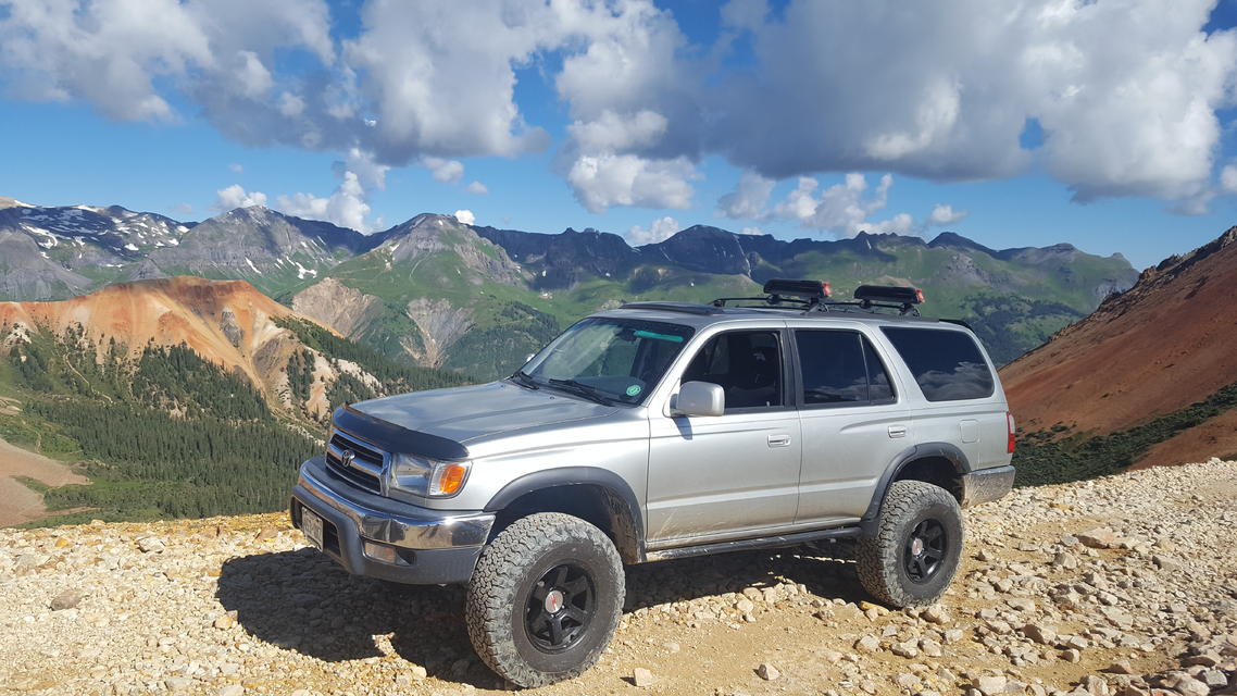

I ended up buying 265/75/16 and new wheels. Sold my nittos for $400. Was it absolutely necessary...nope. But I like the new setup and my truck looks awesome.
