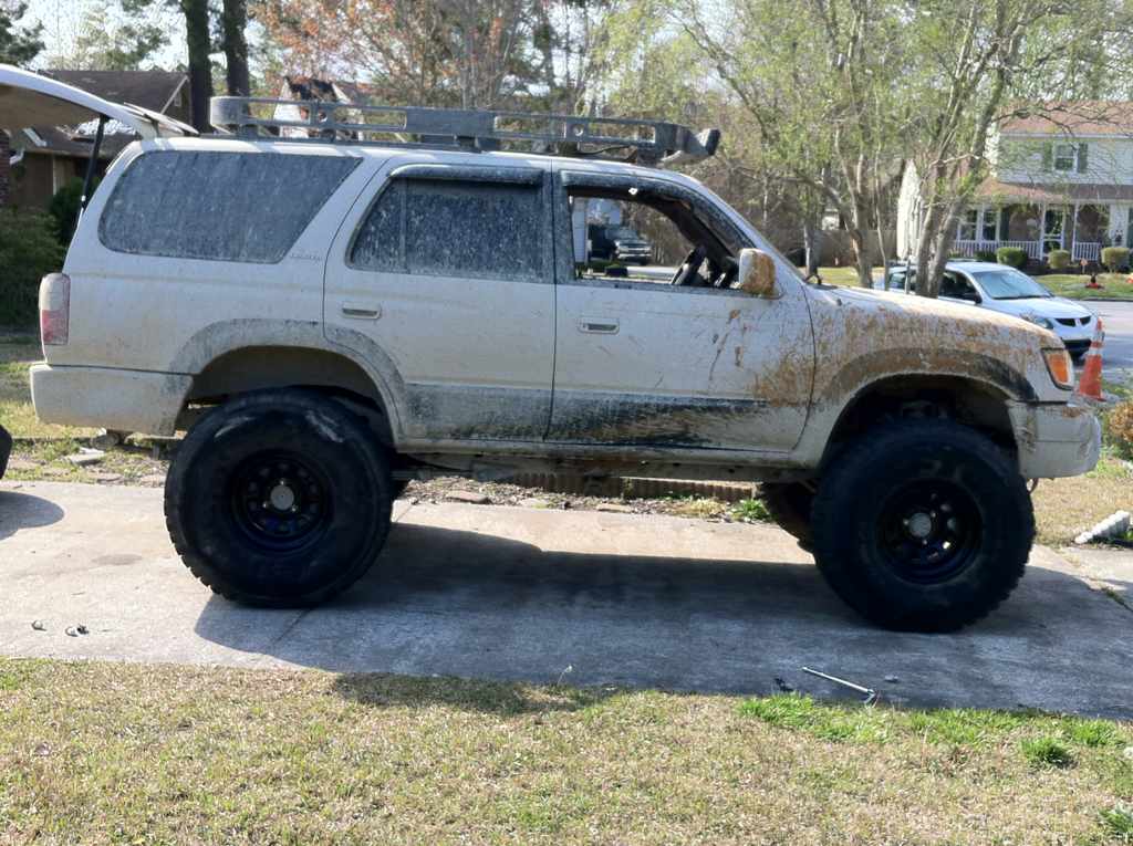

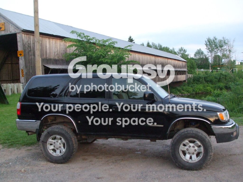

With 3" lift Im running 285's on stock rims and previously i was running 265's but i found with the 265's and a 3" it looked too out of place/ I put the 285's on and they fit great absolutly zero rubbing. only thing is I went with a 1.25" wheel spacers but even with them on I have nothing bad to say, love how good they fit. If I were you id go with a 285/75!
clean4.jpg~original
with 265/75/16
IMG_0151.jpg~original
with 285/75/16
