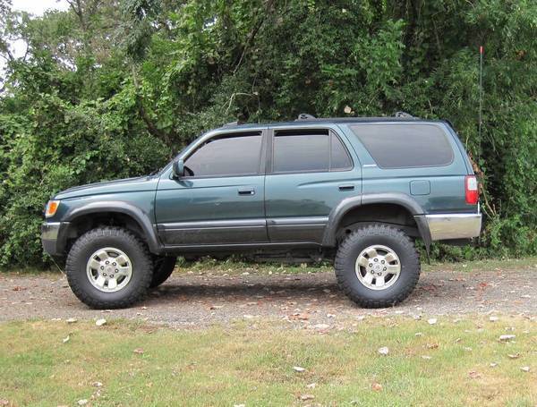

I also kicked around the 285/265 question.
I am so happy that I went 265!
Power is still good so a re-gear is not in my future. And I only have a little rubbing.
It's a little late to add a body lift for me (sliders and bumpers) so I don't see 285s in my future either.
A body lift is almost needed to run 285s.

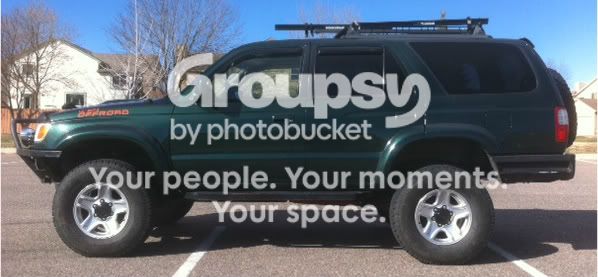

This in my rig. 3.5" in front and 5" in back (ToyTec COs, OME861)
