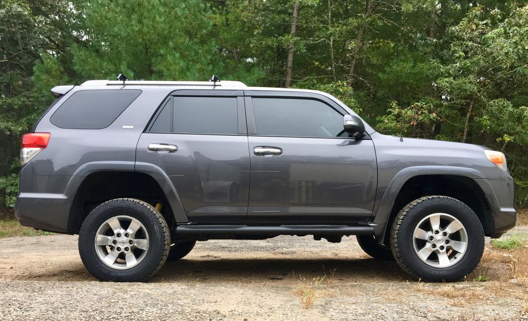

265x65r17 AT3s on stock Wheels problem
I read it 1000 times and done it on past vehicles with no issue, but I had these tires mounted a few days ago, with alignment, and they pull and tram line all over the place. I can’t deal with it.
I have rotated them with no change. Checked calipers to make sure nothing was dragging, and even had another shop verify the alignment was correct. (I do have about 3degrees of caster with SPC uppers, but this was perfect before the tire swap)
So, I’m left thinking that these wheels are just too narrow and not allowing the tire to sit flat ?
I’m running 32psi right now and I do have 1.25” spacers (have been on for years now)
I don’t even want to drive the damn thing right now. It’s that bad.
Could you guys possibly help me out? Shelling out money without a good plan (and shitty results) really grinds my gears.
Thanks
Additional info that might be useful:
2010 sr5
2” Dobinson lift (like butta)
Only think changed was tires
Only reason I kept these POS Wheels is for winter. I know the tires are rated for 7.5” wheel or wider, but I have read about plenty of people doing this.
This causes a conundrum as I don’t want to get new Wheels for winter, and don’t want to spend more money on narrower tires. :mad:
I had the same size tires on it for the last year or so but they were more of a street tire.
Thanks again

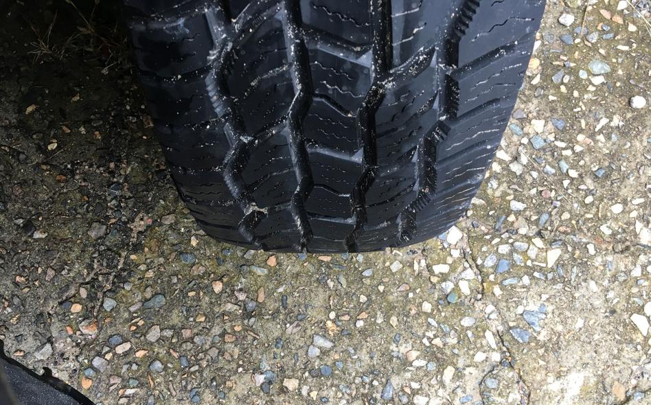

I can physically see the crown of the tread because the wheel isn’t letting the tire flatten our. I don’t know why it’s crap for me and not anyone else. Annoying to say the least

I think the issue is that you went with a tire that has a shorter sidewalk as well as the relatively narrow rim. Narrow rim probably pulls the sides in a little causing the crown.

This is correct, and the problem, I believe. The wheel is 7". Adding more air would definitely make it worse.
Couldn't do chalk test due to rain, but you can see just how rounded the tire is here
