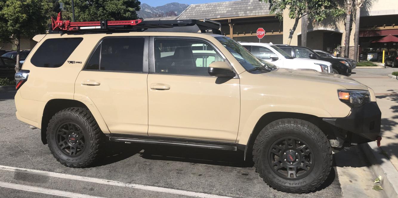

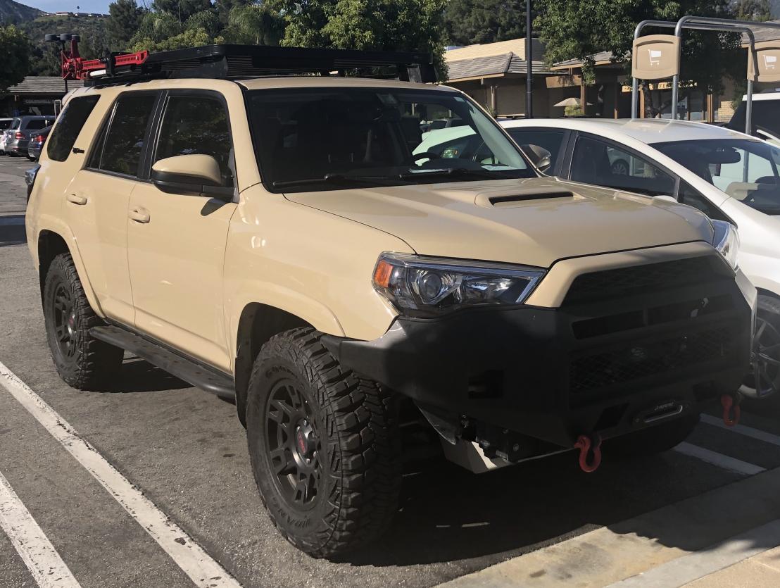

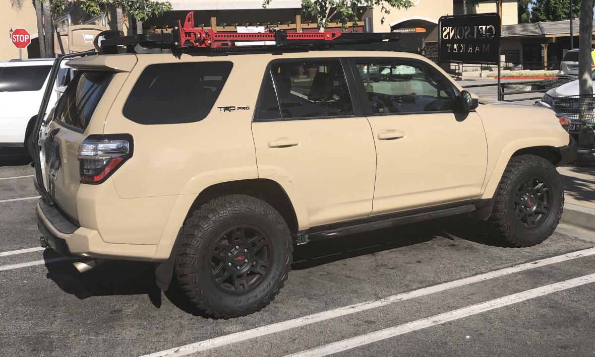

Thought I would post a few pics of a nice Quicksand TRD Pro I saw today where I live. 275-70-17 Goodyear MT/R’s with Pelfreybuilt front bumper and winch, sliders and front runner rack with HiLift jack and shovel. 4Runner was from Montana.

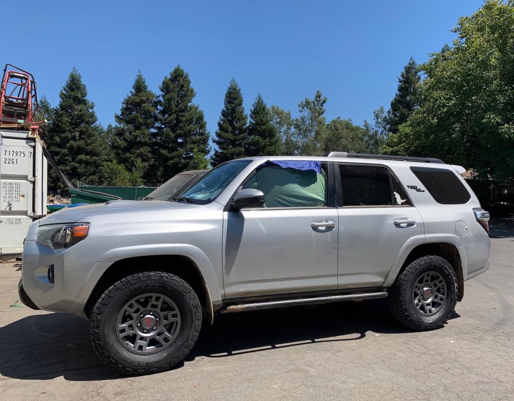

I have a TRD Pro, which, has the fender liner mod and is 1” higher up front than the other 4Runners from the factory. I added Burtman Industries Cornfed 1.5” split spacers to the front and 1” spacers to the rear. I like the setup. No removal of the mud flaps, no rubbing at full articulation or frame cutting required. 275 BFG KO2’s.

How do you like your spacers? Looks good. Any different driving qualities? I.e.; stability, cornering, etc.
I like the more aggressive stance, feels more stable at speed and in turns. Pretty much eliminate the wandering on the highway and when in a high crosswind. Brought a shimmy to the steering and tires from 50-60mph, threw off the alignment and started wearing the tires funny. I removed them and sold them in under two months. I have aftermarket wheels and tires coming now.

Thanks... So your total lift compared to a SR5, Trail or limited is 2.5 front and 1 in the rear?
Looks really good, but based on your approach to lift- isn't your rear .5 inches shorter than the front.
The vehicle naturally has a rake with the rear sitting 1-1.5" higher than the front. Even with the 1/2"differential out back, the rear still sits 1" or more higher than the front. The fronts also settle more due to the weight of the motor. It doesn't take much weight inside or up top for these trucks to sag in the rear. No extra height/lift can account for that, only a heavier rate spring can make up for it.

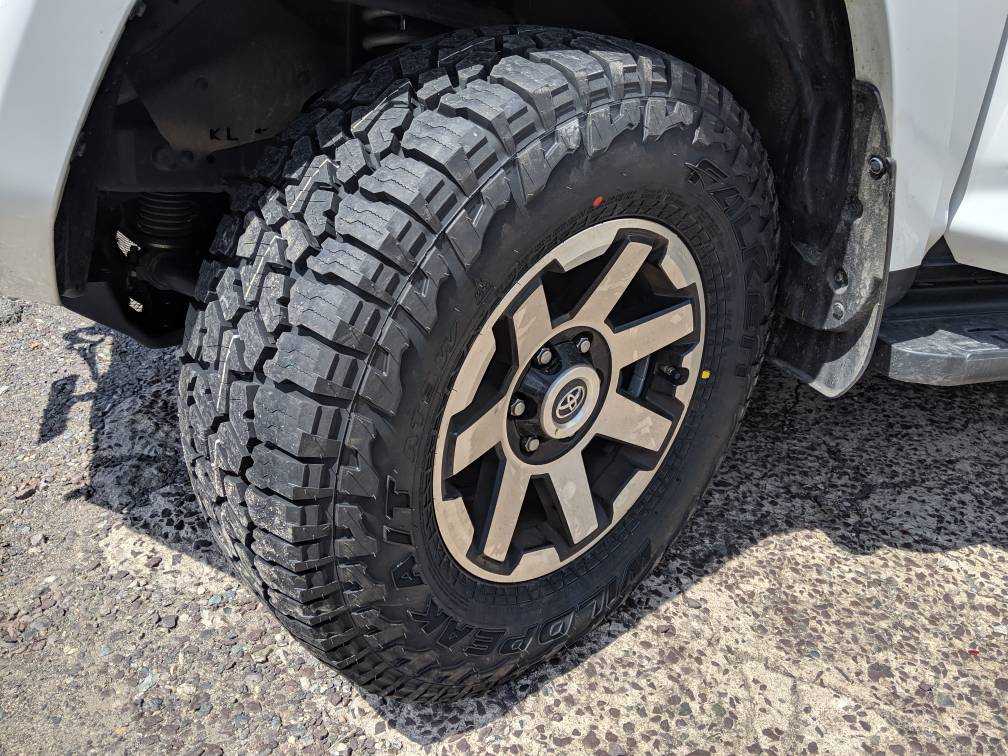

I had the Coopers in a load class C. Went to get them again and didn't like that they only come in E now, so I went with Falken Wildpeaks in a C. Too new to really comment on the Falkens, other than they seem much quieter than I remember the Coopers being when I got them.
