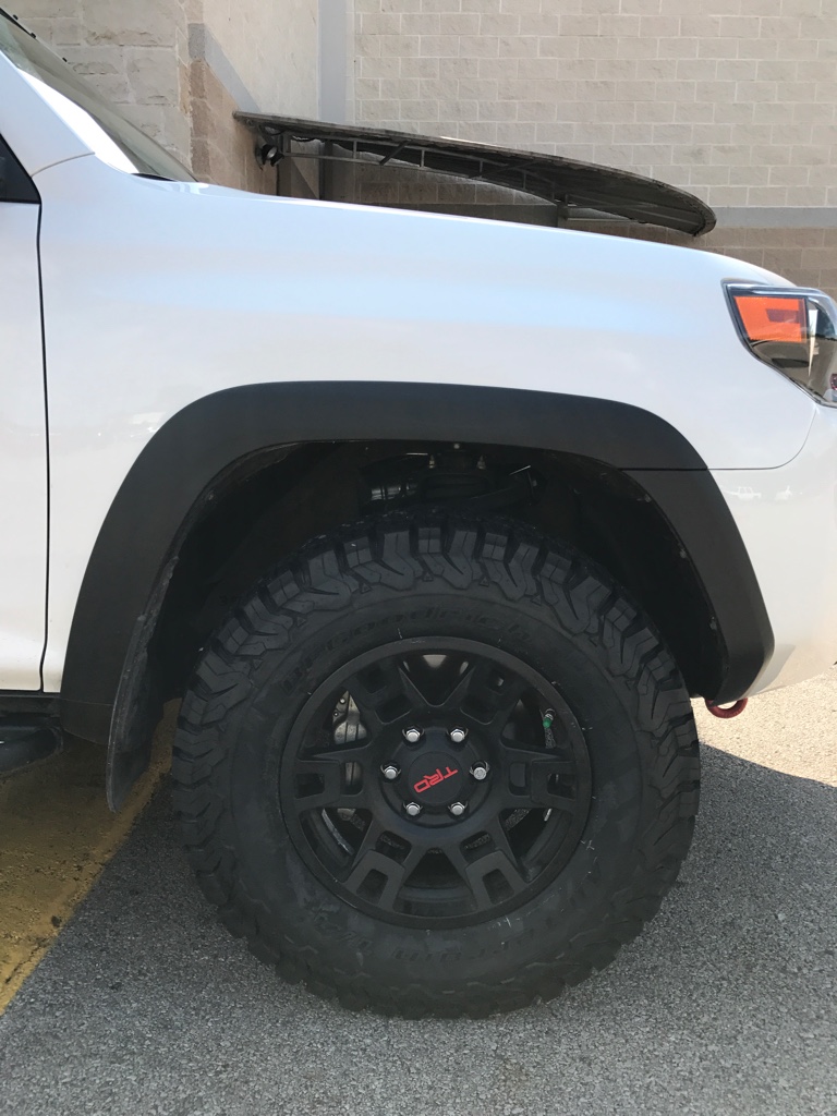

Put 275/70/17 bfg ko2 on 2014 limited with fn f(x) pro wheels. It has 1.5 revtek leveling kit in front, stock in back. Very minor fender liner rub that was easily fixed by the fender liner mod. I like the look. I honestly don't hear them and think the ride is fine (even being a load e).
